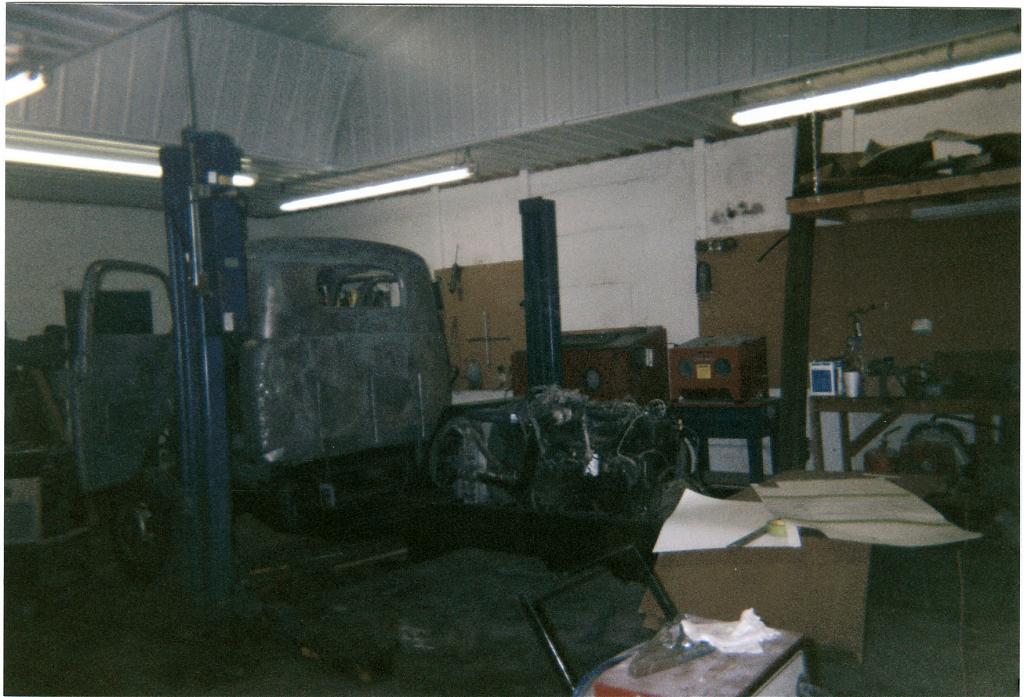

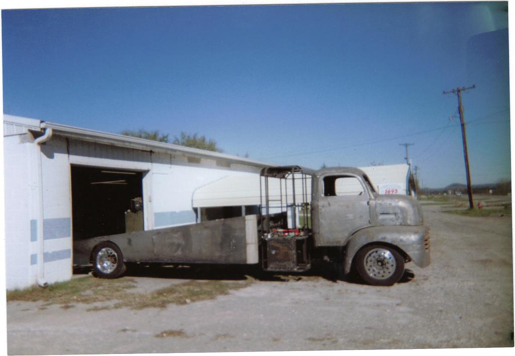

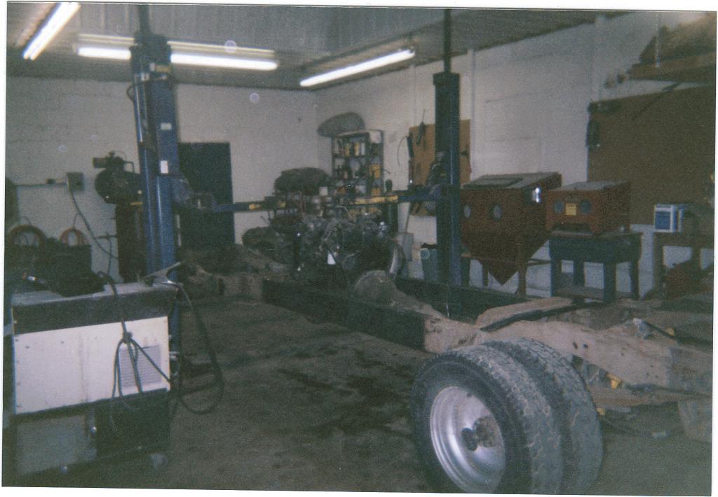

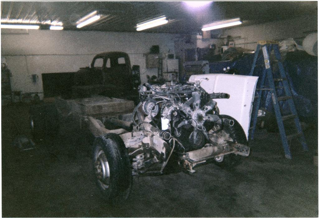

I have put together some photos of building and Cummins install into my 48 Ford F-6 Car Hauler
Attached Thumbnails 48 Ford F-6 Cummins Conversion photos-mvc-139f%5B1%5D.jpg   48 Ford F-6 Cummins Conversion photos-2-16-2008-10%3B10%3B20-am.jpg   48 Ford F-6 Cummins Conversion photos-stretched-frame.jpg   48 Ford F-6 Cummins Conversion photos-stretched-w-cummins.jpg   48 Ford F-6 Cummins Conversion photos-mocked-up.jpg

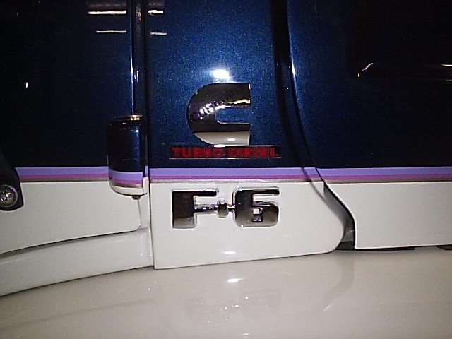

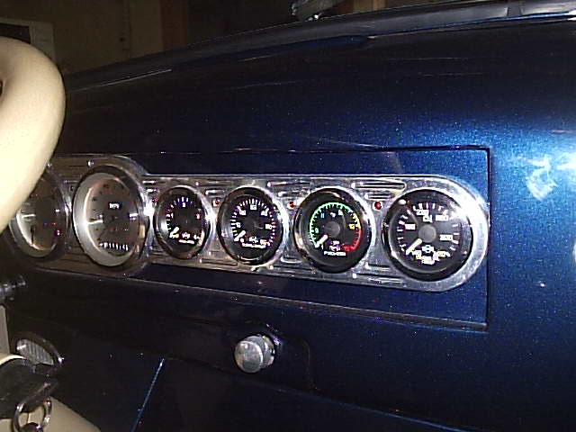

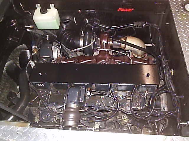

more photos
Attached Thumbnails 48 Ford F-6 Cummins Conversion photos-engine-comp.jpg   48 Ford F-6 Cummins Conversion photos-gauges.jpg   48 Ford F-6 Cummins Conversion photos-f6-cummins-nplate.jpg   48 Ford F-6 Cummins Conversion photos-coe4.jpg

that is incredible, what are the specs on the rig? turbo, fuel, suspension? What kind of air ride system?

Grammabud, That is another reason I put my engine behind the cab. There is just no room under the hood on an old coe for things on a modern engine like the turbo on a CTD.
us mma,
The Ford cab is sitting on a 93 D350 Dodge chassis that has been streched 9 feet. I made a 50 gallon fuel tank and mounted it under the cab where the transmission normally would be, and it has Firestone air bags with on board air compressor/air tanks. It weighs 13,600 lbs with my 34 Dodge sedan on it, and it gets 12.5 mpg loaded.

Grammabud,
I don't really know/remember the particulars on the cab mount /turbo clearance issues you are having. When I put my engine in the rear behind the cab, I knew it would eliminate any of those issues from sticking its ugly head up in the middle of the job after I had already spent many hours into it then realizing it wouldn't work anyway. If you are not making a car hauler, that may not be an option for you though. I have seen guys out the engine in the rear behind the cab with a regular pickup bed, but there isn't much room left to haul anything if you do that. On my hauler bed, that was just dead space anyway and worked perfect. Plus, other benefits are: More leg room since no more hump in the floor to cover the engine, no heat coming up through the floor in the summer, less noise, and the driveshaft is only about 3 feet long instead of 12 feet. Much less to go wrong with a short driveshaft. Putting the engine behind the can only seemed like the best thing to do to me
