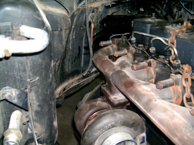

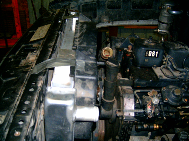

Old Aug 11, 2008 | 08:15 PM
  #51
sixb's Avatar
Posts: 228
From: West Jordan, UT

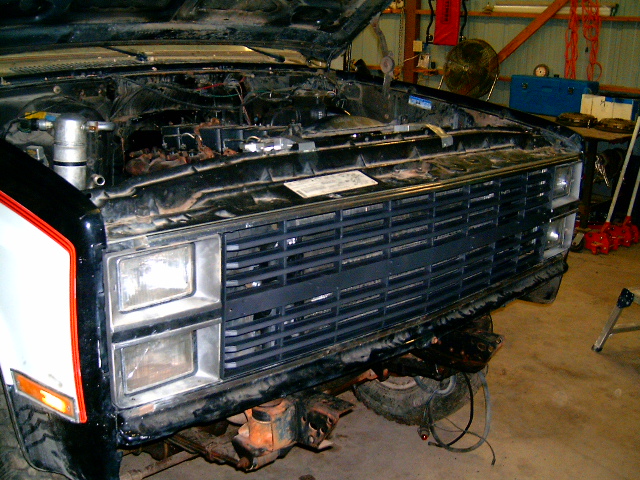

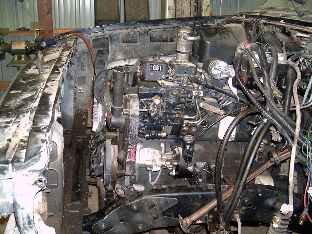

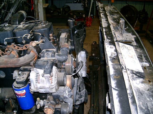

Well i got the engine where I want it and it's going to be tight with the radiator and will require some cutting to use the 92 dodge radiator. Here are a few pics.

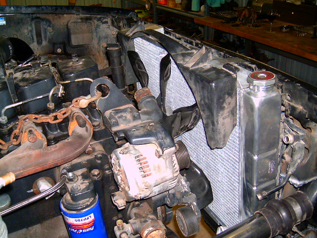

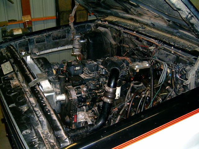

Old Sep 10, 2008 | 08:22 PM
  #53
sixb's Avatar
Posts: 228

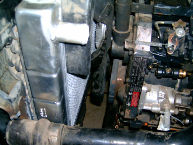

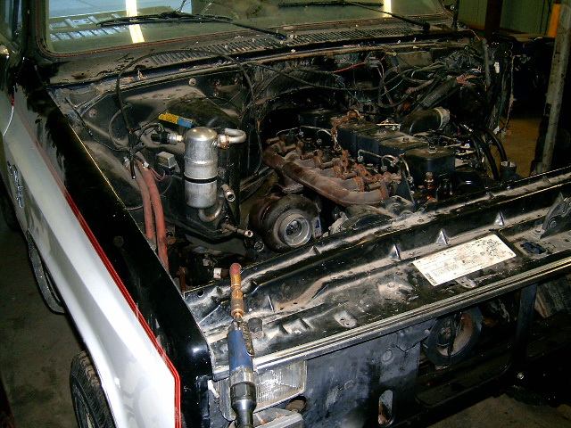

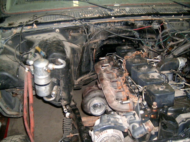

Well I decided to go with an alumn. radiator from summit racing and it is going to work perfect. I also got the intercooler and the piping in there. Here are a few pics. I need to find a new fan shroud and make a few brackets for the radiator, then I will put the tranny and t-case in there and build a crossmember. Then take it all apart again and fully box and paint the frame.
