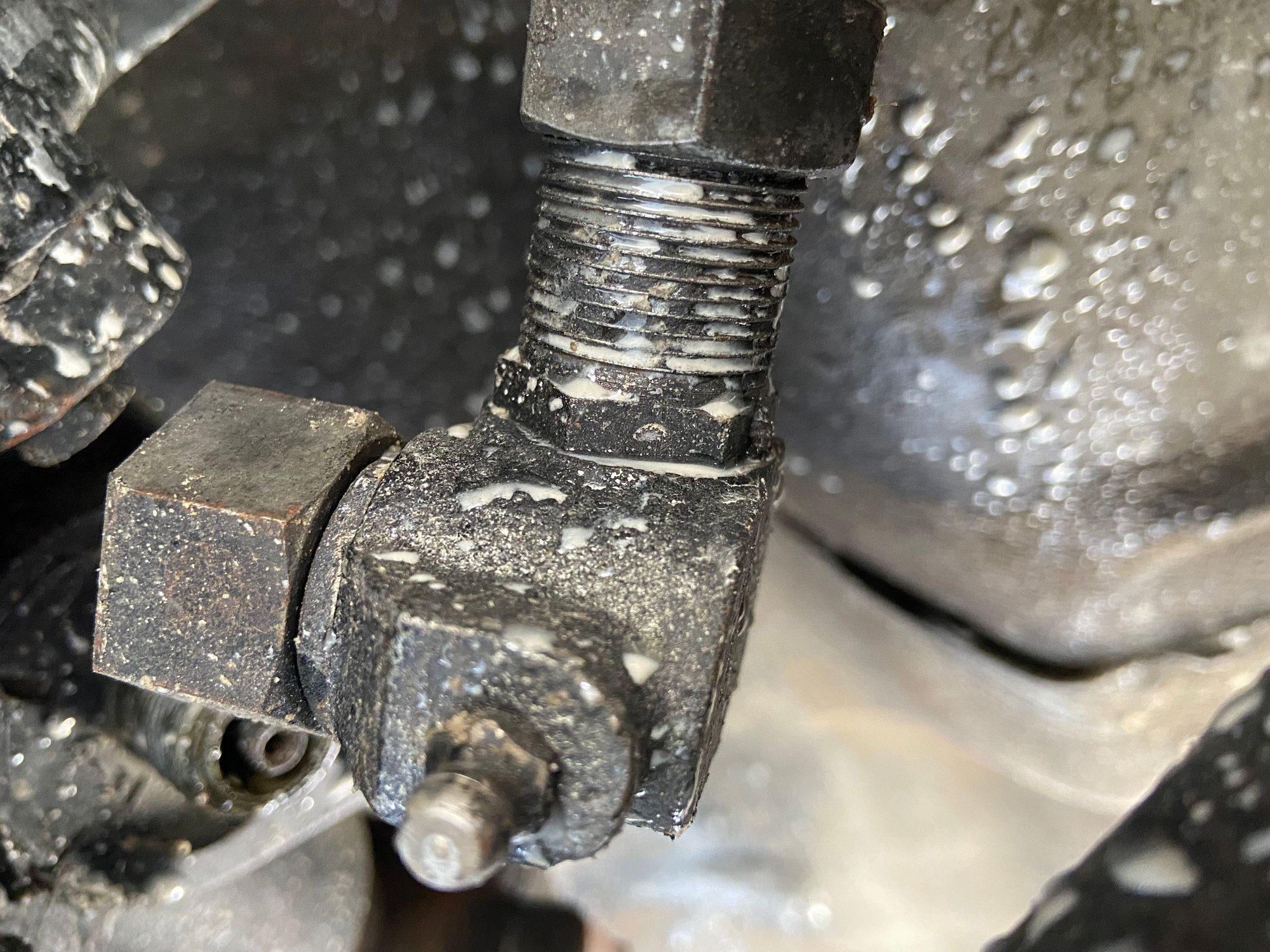

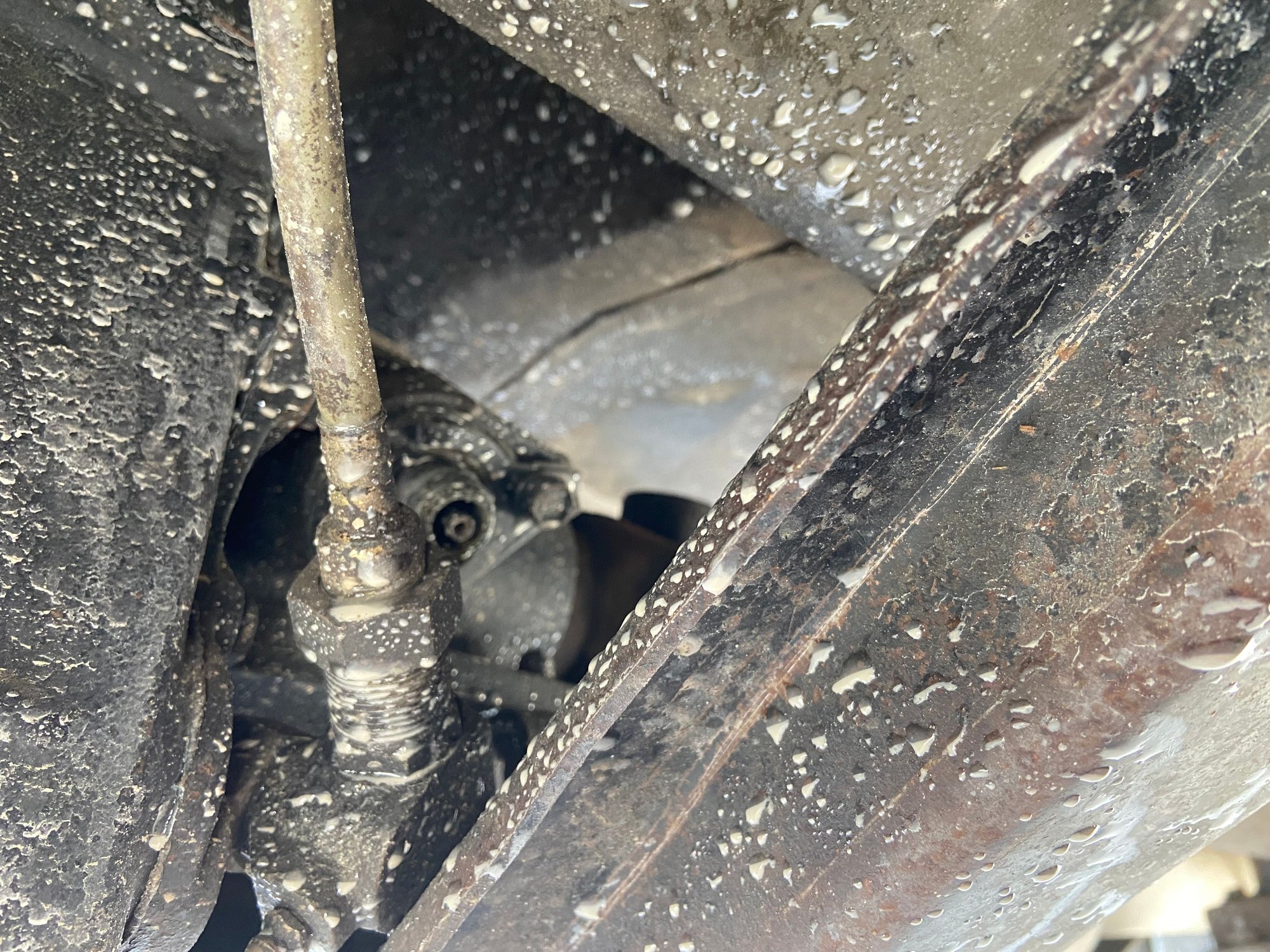

I
Is this the way it is connected? Just direct like seen?

Not exactly. In the 2nd picture, in the back ground is where the cable should be screwed onto. You can see that the speedo gear is held into that 2wd transmission by a bolt and a wishbone shaped piece. The cable should have a male square drive that will slide into the that hole in the center on the speedo gear on the transmission.
I hope that all makes sense.
