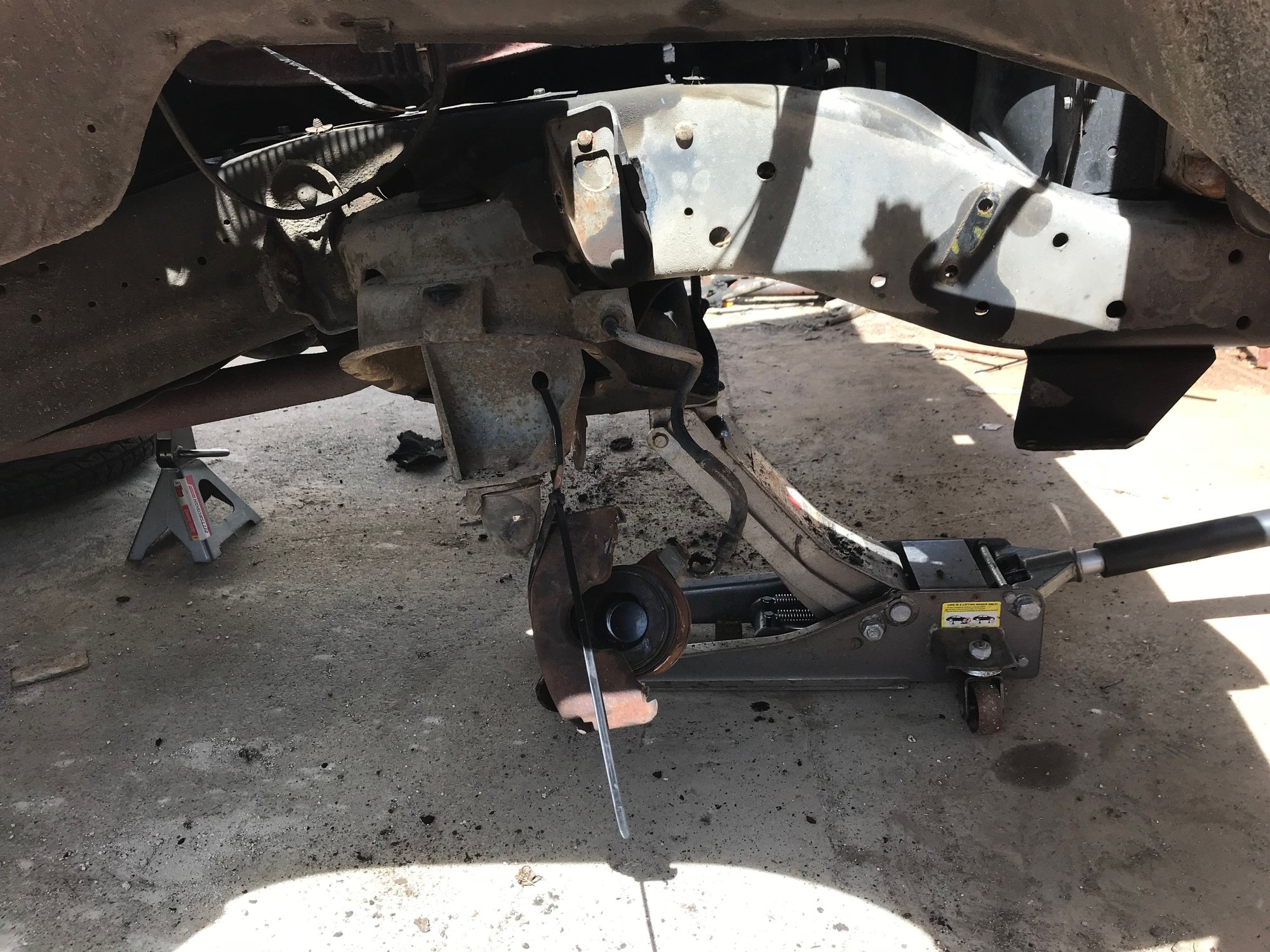

so before I stab the cummins into the crew cab I am rebuilding the front end on the 1983 d350. I have upgraded all the suspension and steering parts to 1993 (diesel) products and ran into a small snag.
Everything fits its except the diesel outer tiered ends will not fit into the gas steering knuckles.
I am left with 3 options.
1-tear it back down and use the knuckles from the donor truck after I get them off the donor truck
2-send back the diesel tie rods and order the gas ones for the correct year.
3- drill out the knuckle to accept the larger tie rod end.
Thoughts?
all help appreciated.
Old Mar 25, 2018 | 09:09 AM
Posts: 6,837
Not number 3 unless you're a machinist by trade, or have one you trust can,produce the proper taper in the knuckle end. Problem I would,think, is the enlargened hole would exceed the design tolerances of the knuckle.
