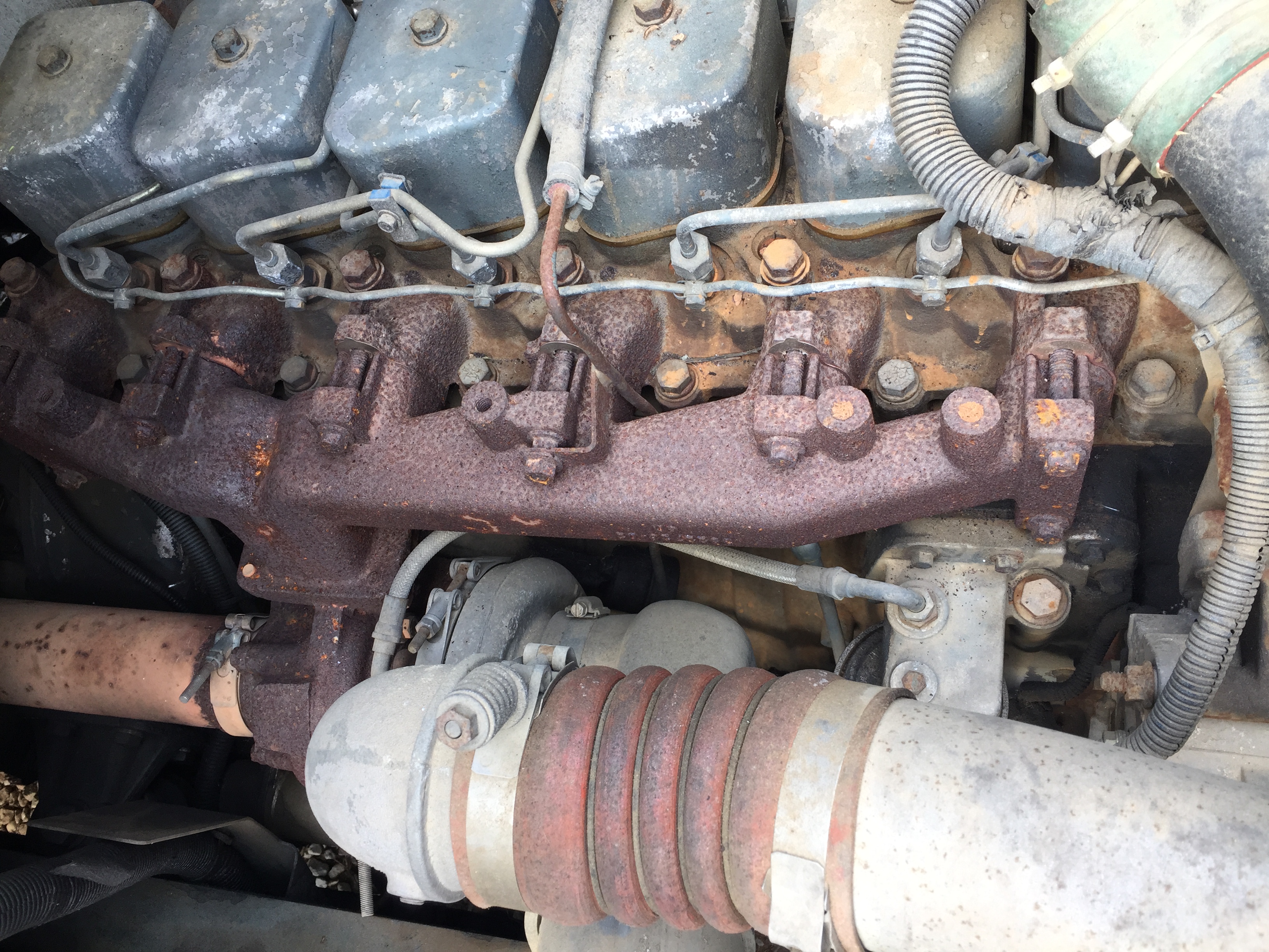

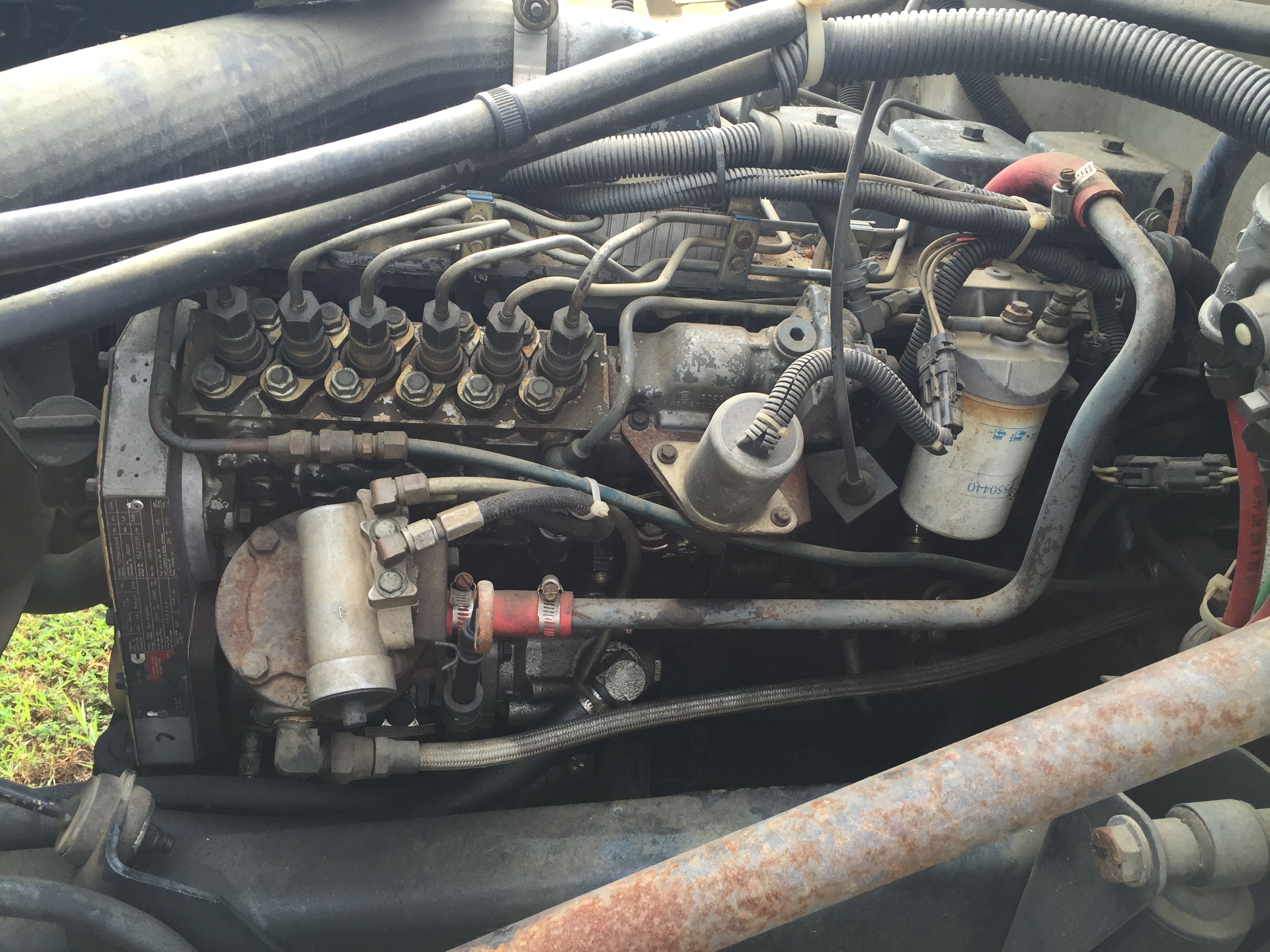

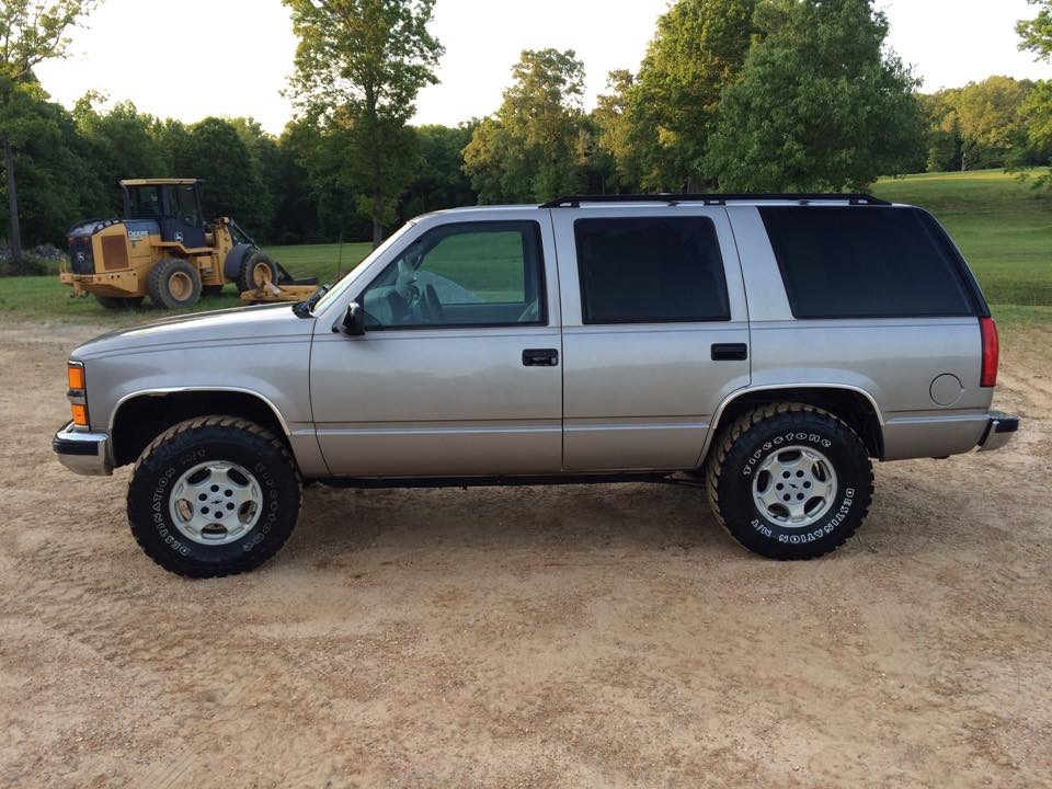

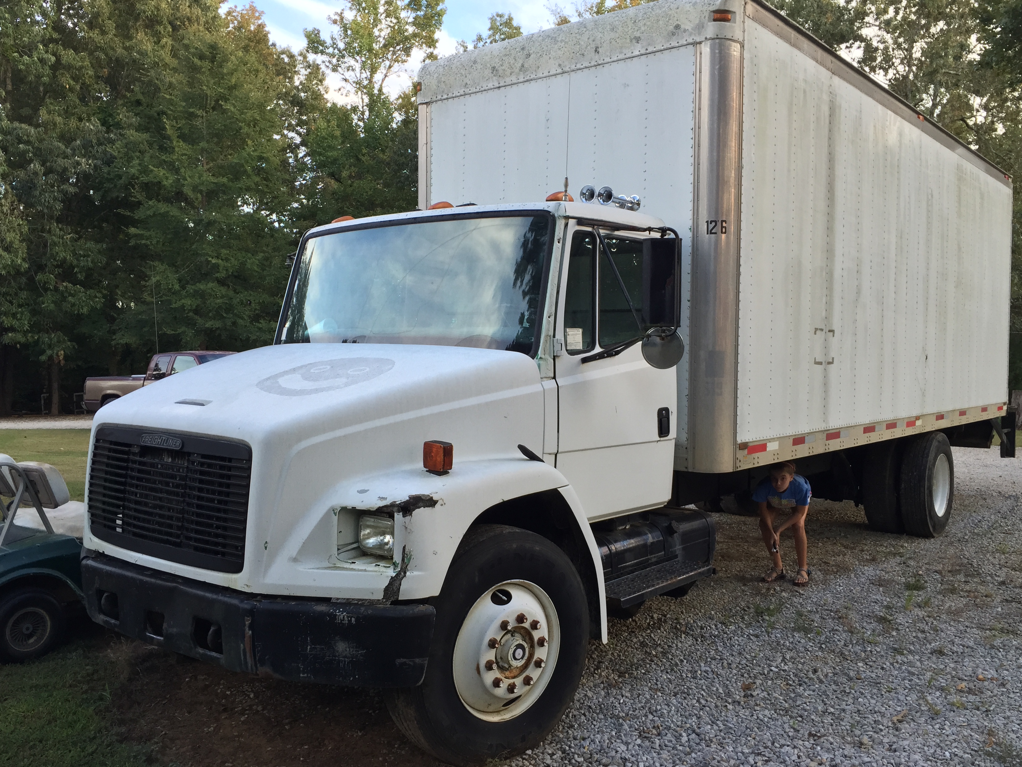

here is some pics of the motor, the truck its coming out of, and the tahoe i am putting it in
Attached Thumbnails 12 valve power and mpg-img_0735.jpg   12 valve power and mpg-img_0737.jpg   12 valve power and mpg-img_0738.jpg   12 valve power and mpg-img_0758.jpg   12 valve power and mpg-img_0138.jpg
