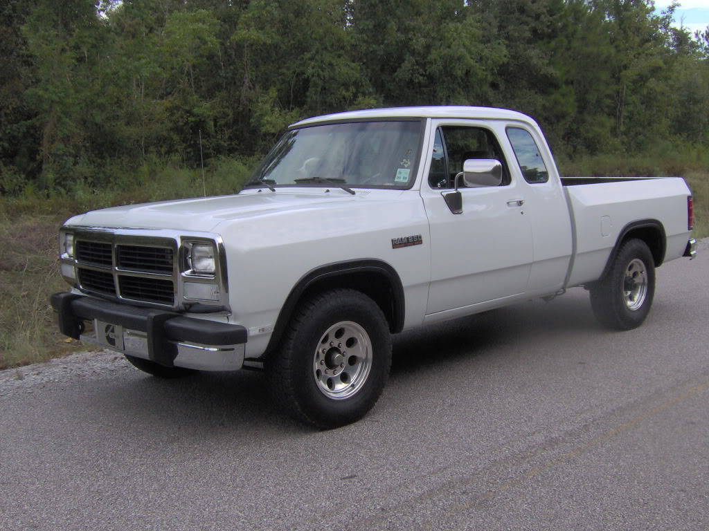

Heres another.
TOMMY

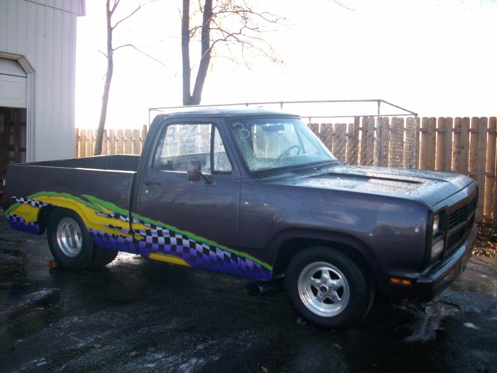

here are some pics of our 1/2 ton cummins
i love your truck man. a prostreet diesel does it get better than that.

Originally Posted by TOMTOM
Heres another.
TOMMY
Love that truck. Where did you get the clear marker lights though?
Old Dec 23, 2009 | 05:22 PM
TOMTOM's Avatar
Posts: 234
From: sulphur louisiana
Ebay search (RAMCHARGER CLEAR)
TOMMY

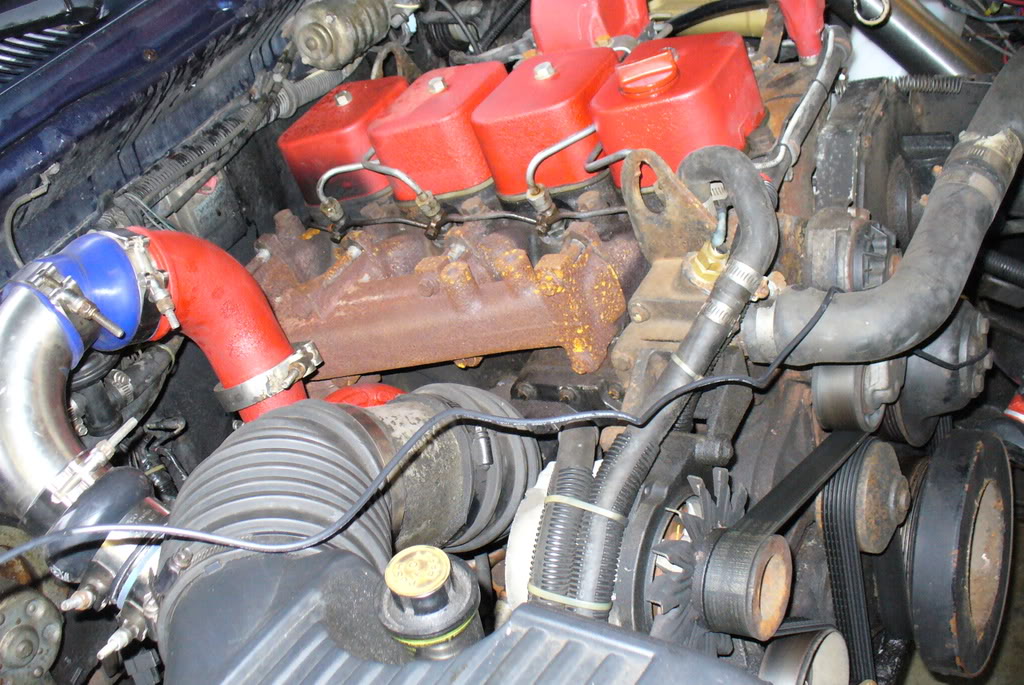

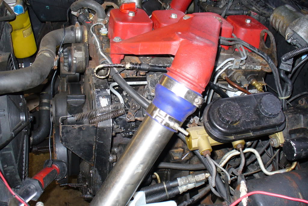

Wow, that 4Bt looks like it was made to fit in that rig.
Old Dec 27, 2009 | 08:25 AM
dillenger1's Avatar
Joined: Dec 2009
Posts: 95
thanks ive got a hy35 on there with non-ic 6bt injectors,which do better then my edm'd 5x14 sticks.boost is 27psi.ive got a nv4500 out of a 97 cummins,with a 3.55 gears in the axels.Noproblem running 70mph at 2000rpm
