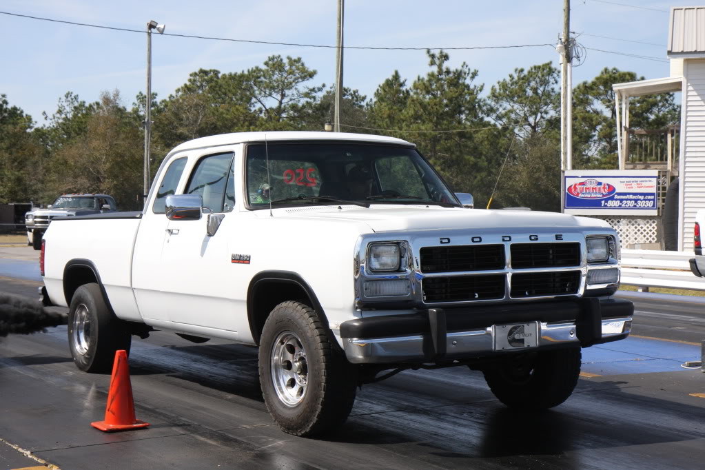

Heres another.
TOMMY

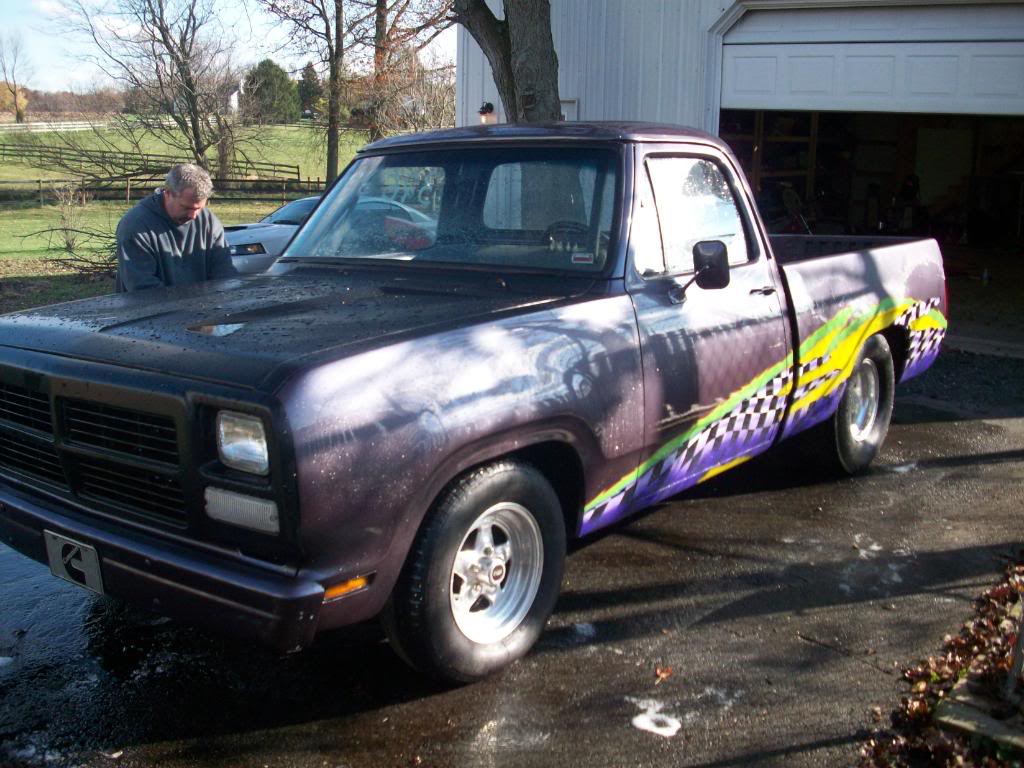

here are some pics of our 1/2 ton cummins
Old Dec 23, 2009 | 05:04 PM
1bad93's Avatar
Joined: Jun 2008
Posts: 629
From: york pa
i love your truck man. a prostreet diesel does it get better than that.

Originally Posted by TOMTOM
Heres another.
TOMMY
Love that truck. Where did you get the clear marker lights though?
Old Dec 23, 2009 | 05:22 PM
TOMTOM's Avatar
Posts: 234
From: sulphur louisiana
Ebay search (RAMCHARGER CLEAR)
TOMMY

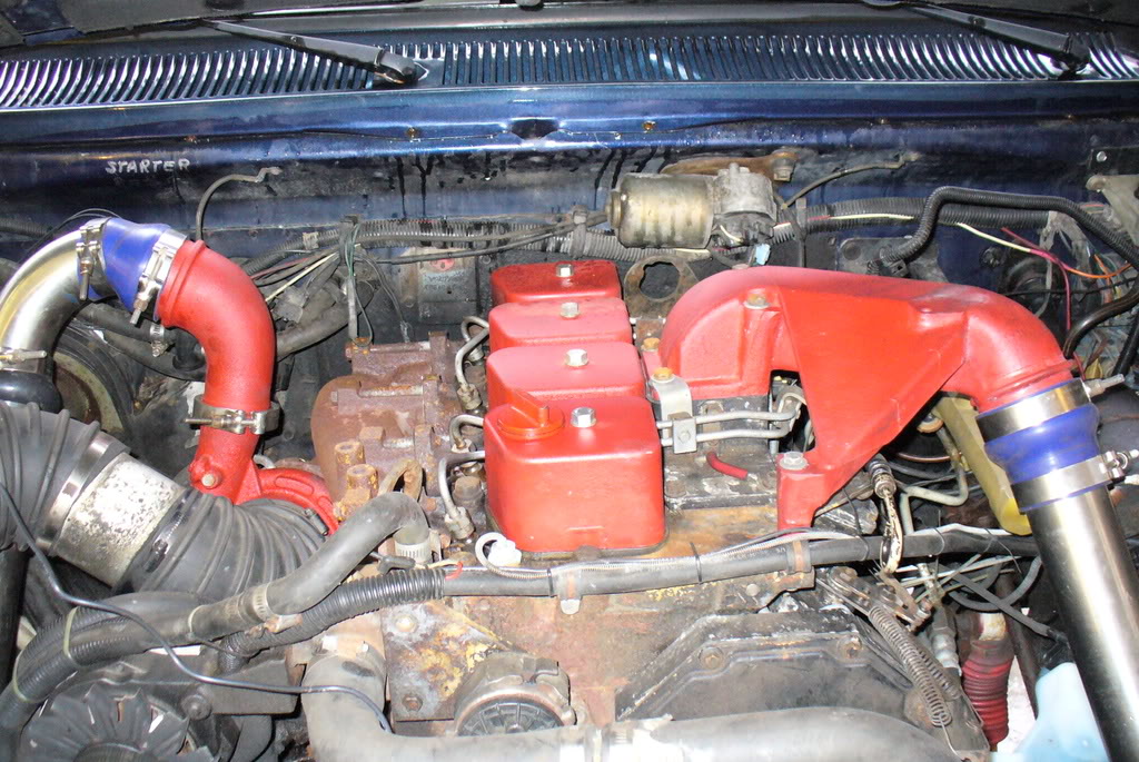

Old Dec 26, 2009 | 09:32 PM
Bluedeviltorque's Avatar
Joined: Mar 2004
Posts: 303
From: The Hardware City
Wow, that 4Bt looks like it was made to fit in that rig.
Old Dec 27, 2009 | 08:25 AM
dillenger1's Avatar
Joined: Dec 2009
Posts: 95
thanks ive got a hy35 on there with non-ic 6bt injectors,which do better then my edm'd 5x14 sticks.boost is 27psi.ive got a nv4500 out of a 97 cummins,with a 3.55 gears in the axels.Noproblem running 70mph at 2000rpm
