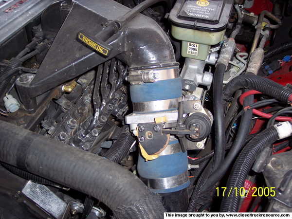

Originally Posted by rage_blue
The BD valves look easyer to install than the rhodas. Looks like theres no more dismanlting the alt for an RPM sense.
Thanks for noticing rage-blue we heard the RPM feature may be mandatory in some areas but it is hard to get any definite answers on requirements for the Positive Air Shutdowns.
any and all feedback is appreciated!

I don't know the sites you visit, but every site I go to "Diesel PAS" is a check mark on the standard work permit. Without one, I can't get through the gate.
The one I have from Roda is butterfly as well but this makes the competition much greater than when I had to buy one. There were no others..

The BD valve is a great alternative for us now and also for those in competition requiring this device.

From guys i talk to, The valves have been requireed for a quite a few years on natural gas sites and rigs. They were required but it was up to the consultant or operator to make sure you had it. The RPM sense is becomeing more mandatory in the last few years. When the patch was busy you could get away with haveing nothing at most places. But now things are slow, oil companys are getting sticky, and are more willing to tell you to go home if you don't have all the equipment they require. I haven't seen any engines blown up from natural gas but I have seen head gaskets blow becuase of over reving and no rev guard. I've worked for trucking companys, and all the trucks had rhoda valves and all the other saftey stuff required, so that no work was lost becuase of missing saftey equipment. From what I have been told, the vavle is there to stop a blow out not to save your engine, but it does save your engine too. I think gas jobs get away with it becuase they are snubbed out by the throttle plate. Not to say that a bad spark plug wire wouldn't cuase a blow out. Most of the time if you don't use a rhoda valve it gets stuck and won't work anyhow when you do need it lol.
