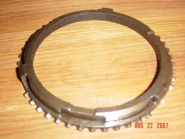

I put 50,000 or so HArD miles on my red truck with GL-4 Penzoil synthetic 75w-90.
has to be GL-4 rated oil HAS TO BE GL-4 rated oil. Joe the oils that are recommended for the NV5600 are not for the NV4500.
or you can kiss these babies goodbye
