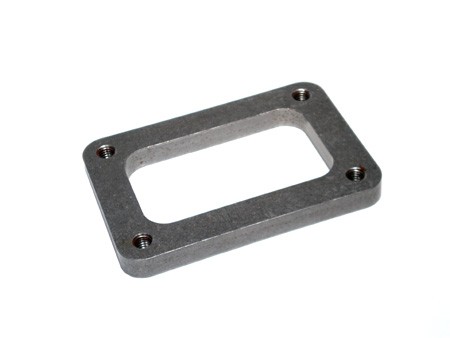

I just ordered a few more parts, so it might start to look like something....
Me too. The T6 flange I ordered will be divided. Didn't know whether to order divided or nondivided.
I figure I can smooth the divider to aid flow into the scrolls. ??
I got 2, T3 flanges coming. I hope to weld them together and make a ED gated flange of sorts.....

Steve, good work buddy. I just used nondivided T6 flange on my twins? You getting drill and tapped flange or a raw flange? I would build an exhaust manifold and run an external gate, than run the ED drill exhaust flange adapter. I just bought a seat, five point belts, nylon mesh for the windows, kinda boring but needed to keep the build alive. I have to order pistons, gearbox cover, adjustable timing gear, next week. My 24v head is cracked, so I have to find something different.

For 26 USD I imagine its just a raw flange with holes. I can tap easily enough. I'm just curious to see well the opening will fit with a 3" sched 40 elbow.
