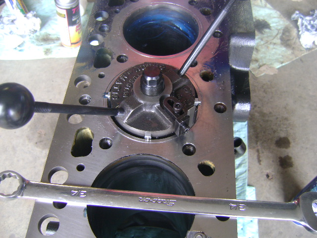

A look at my 1st cut into the block with the o-ring tool. This cut was .020 deep. If Cyl #2 o-ring grove looks rough, no fear it is just lint from paper towel!
Attached Thumbnails Donkey Power.  Engine build getting out of control.-engine-3.jpg

O ring tool at work....... kinda!
Attached Thumbnails Donkey Power.  Engine build getting out of control.-engine-4.jpg
