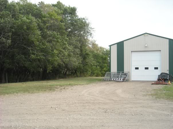

DODGER BOMBER's Avatar
Posts: 689
From: Kelliher, Saskatchwan, Canada
Originally Posted by cLAYH
Are they as well insulated? Are the ok for inside city? Ie does it look like a barn or a garage?
There post buildings. They are tin buildings that are ordered to what ever size you want. Mine if 30x42 and i insulated it with R20 on the walls and roof but im redoing the roof with spray foam hopefully this year. Mine kept warn this winter to the point that i didnt have to plug my tactor in at minus 40 to start the dang thing. Pretty reasonable too. I think mine was 25g put up with a role up door and man door.30Wx42Lx16H.
