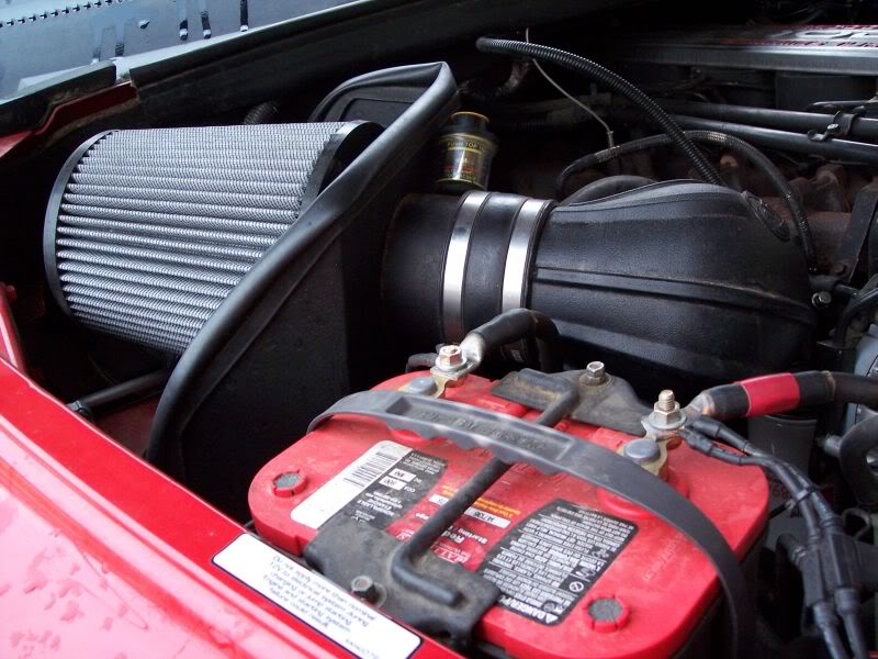

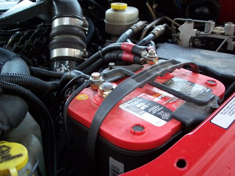

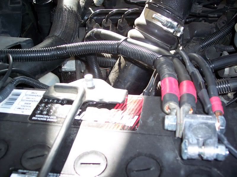

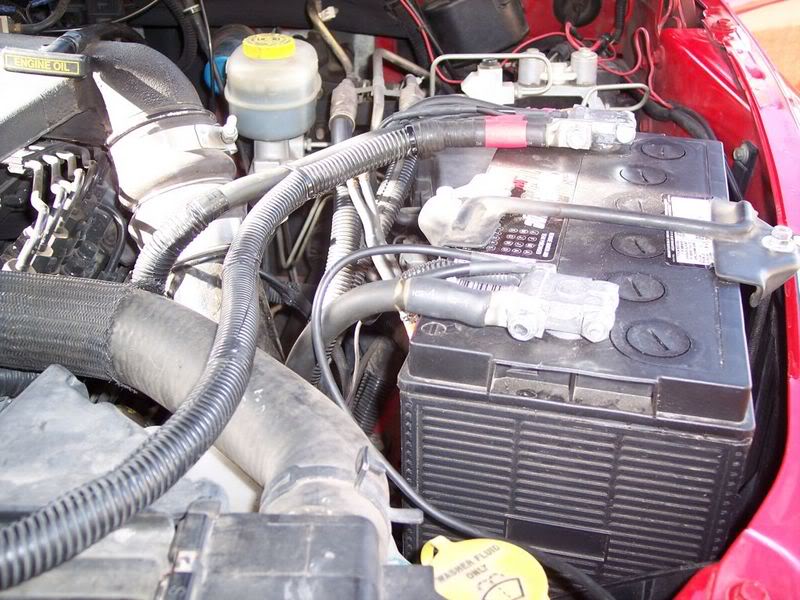

Yes, they should fit. Like I said, I took a grinder and cut out 1 side of each of the battery trays. As well, you will need to make longer battery hold down rods. I used 4 mm ready rod and two nuts tightened against each other.
The biggest thing is to make sure you have enough slack in your oem battery cables to reach the group 31 posts, and to make sure you can close your hood without shorting the posts (that would be fun).
Group 31's -
Optimas for comparision -

I've got Group 31's with stock hold down bolts. The cable was a stretch, but it just works. I had to adjust my hood higher on both trucks when I put them in, they are about an inch larger in all dimensions.

Dr Evil, how come you engine compartment is so clean. Man you could almost eat my supper of those valve covers. Everywhere I touch under the hood of my vehicle I get a nice coating of grease.So I think the front axle is well lubercated.
I sized up those group 31, man they are biggies. I whimped out and just but a set of group 65 again. I have to many mods under my hood to fight with everything, the 65's fit in nicely. These new batteries have a 5 year warranty, for any reason, they don't work, I get a new set of batteries. Right off the bat, I noticed that my voltage didn't drop as much with the new batteries, and no check engine light.

Dr Evil, did you put on different battery cables? Those don't look factory and the battery clamps look way nicer than what I have. I think you posted that earlier, but just want to clearify that abit. The battery cable end clamps don't look factory either.
Old Jan 24, 2010 | 12:11 AM
  #87
Dr. Evil's Avatar
Joined: Jul 2003
Posts: 7,129
From: The Great White North
Yes, you are correct Mike, that is 2/0 welding cable which is quite a bit larger than the stock cable. You can also see the heavy duty ring terminals (I believe they were Thomas and Betts) that I crimped on when I had access to the tool crib at the power plant.
The clamps that i am currently running are brass marine type available from Parts Source or Cambodian Tire. They are nice because they are not soft like lead, but I have broke one (on my way out of town on a long weekend !) due to the engine vibration and weight of the heavy cable.
The first ones pictured are the military style clamps. They were pretty good, soft because they are lead, but on the other hand, its nice to have that big mass of lead there - sure helps to conduct the juice. I got them from these guys: http://www.pullpal.com/terminals/terminals.html
The major problem with doing this is that there are so many cables running from that Drivers side +terminal (I have 6 cables running from the drivers side +terminal - 1 to the other battery, 1 to the starter, 1 to the grid heater relays, 1 to the PDC, 1 to my alarm, and another to my BD Torquelock)
I have a few links for the HD Ring terminals if you want to go that way, or they can be had from Gregg Distributers, or Acklands.
Let me know if you need any more info - Id be more than happy to help you out Mike.
BTW, my engine compartment isnt that clean - its photochopped
