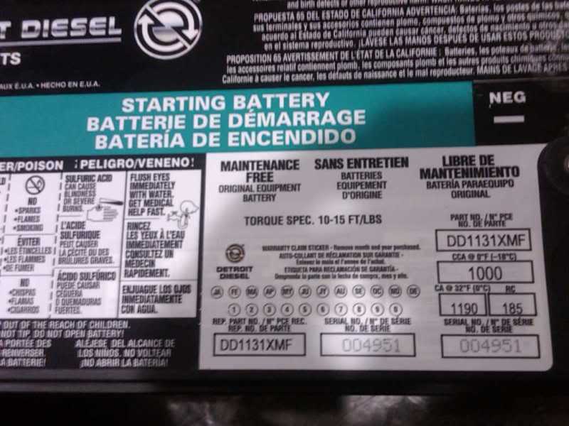

1-5-3-6-2-4's Avatar
Posts: 3,142
From: Okotoks AB

do these batteries have side posts also?
do they fit on each side of our trucks without modification?
I had to cut out on end of my battery tray to fit group 31s. Imagine would be same deal with these.

Originally Posted by 1-5-3-6-2-4
they are made in the USA. for sure. I asked the parts foreman, the company is called Power Batteries - IIRC.
any way they are Detroit Diesel brand. Group 31, 1000cca $90 over the counter at Waterous.
Thanks Luke ! Are those a sealed battery?
The more and more responses here I see just reinforces the fact that there are very few battery manufacturers. Probably three different people have recommended batteries and they are all rebadged Dekas. Which is what I initially had. I had premature failure and Im starting to think I just had bad luck - I did replace my alternator last winter, so maybe it was undercharging or some other issue.
Posts: 3,142
From: Okotoks AB
they are sealed units. yup.
