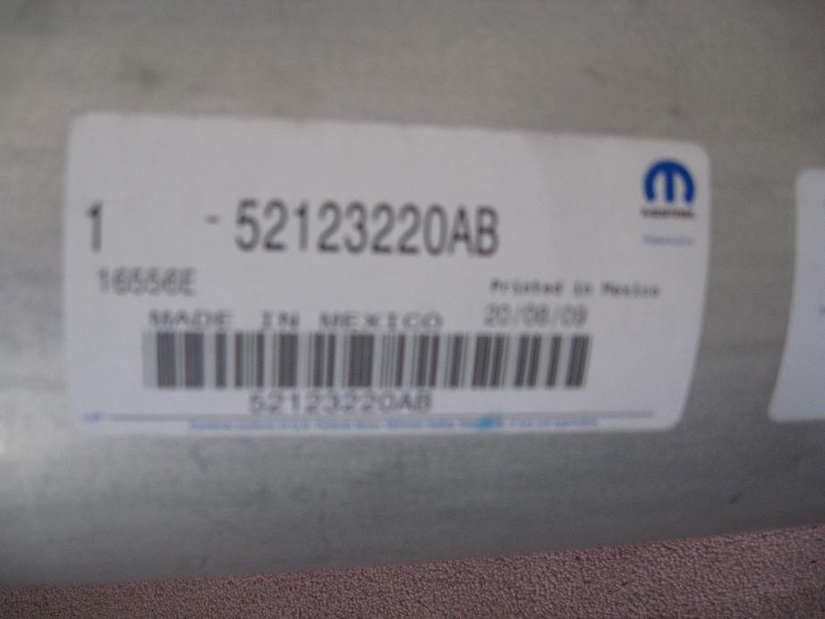

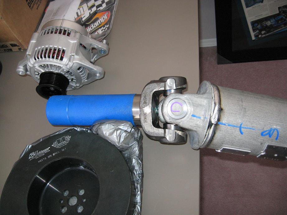

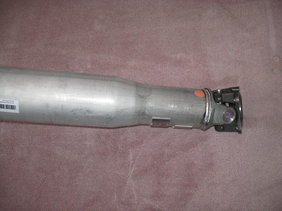

2007 5.9 Mega's came with a 2 piece--6.7 was when they moved to a 1 piece.More of just a preventative thing,eliminate the center bearing vibration issues and have just 2 U joints.About 77 inches long,6 inches thick in the center.No info on the REVO's 2 so far.
