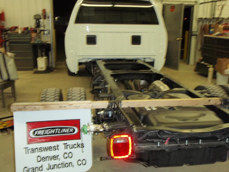

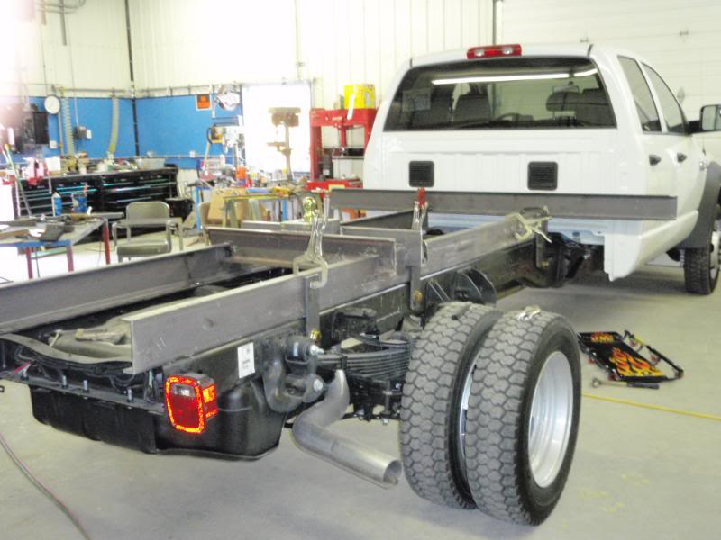

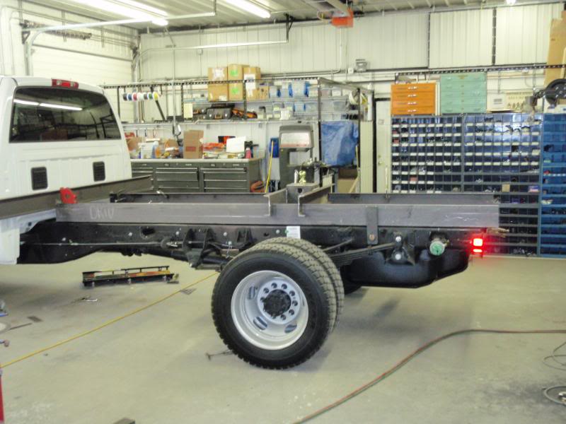

Here is some pics from the bed build:

The Bullet is going to be 3 Y/O on May 5th ..It's about time to hit a great big bump in the road and have some things fall off of it..
your shop is too clean. let me come up there and play for a little while. maybe I could get my fuel tank done too! LOL
