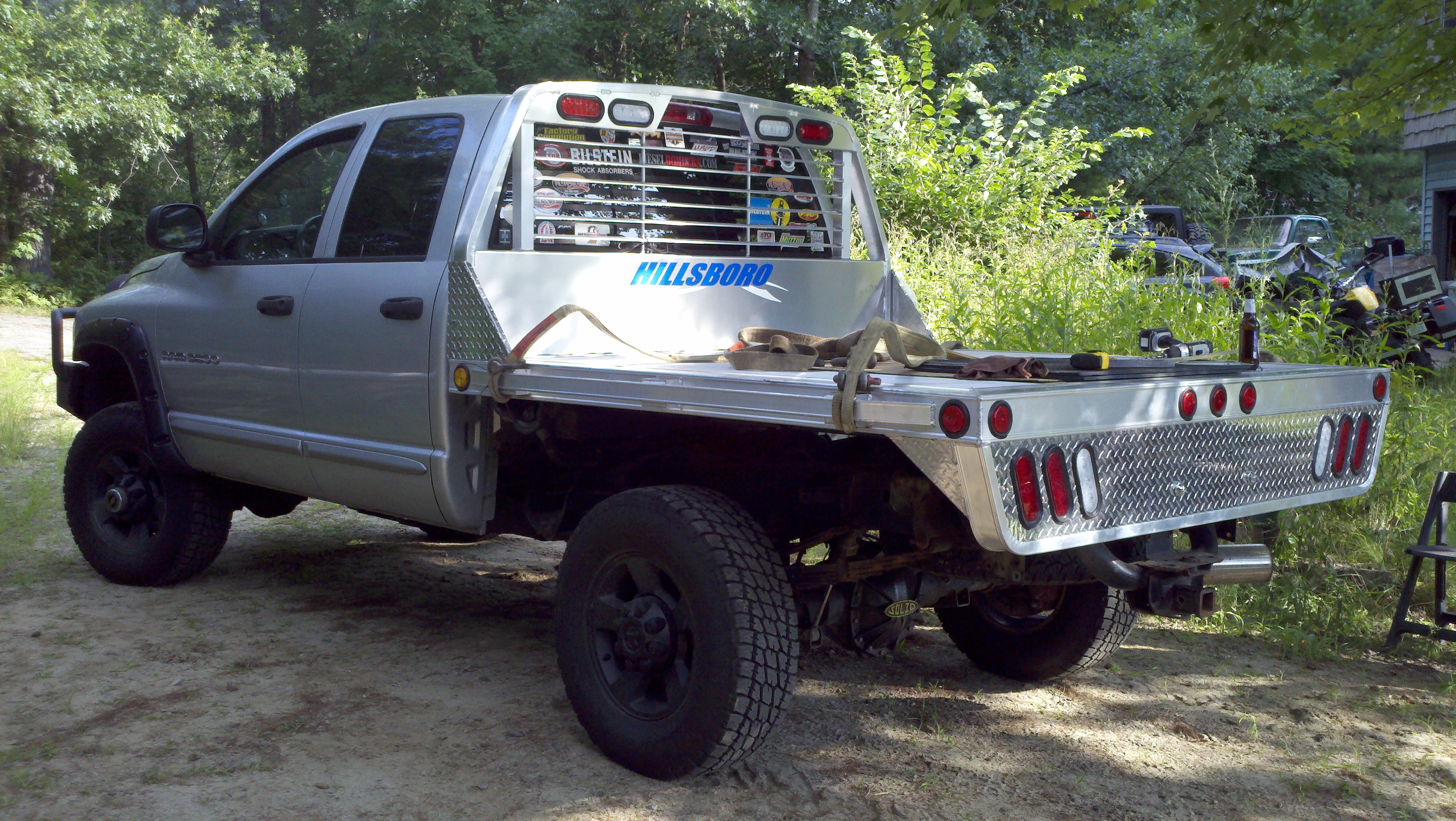

When I installed mine I used stainless tube steel crossmembers across frame rails first,achieving what you want.
