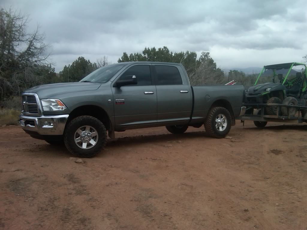

these are 295 70 17, no lift no rub..trail grappler

How do you like the trail grapplers so far?

well i like their off road performance pretty well, i dont think ill get the mileage out of these tires that i expected. road noise is very minimal. i believe these tires would work better for mileage in a 1/2 ton application
