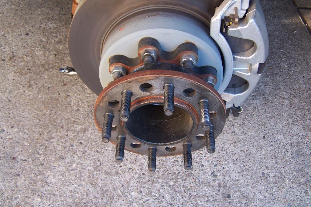

How to overcome offset of wheel
Ok.. still have the small flare sections for the front bumper but the bigger question still remains. How do I fill up that big wheel well now. The 8 lug wheel is obviously smaller than the 10 lug setup. Im not really interested in those 19" wheels and tires. If I could get the over all wheel to set out more like the 4500's it would look better. I thought that I might be able to order the steel spacer that goes between the rotor and the wheel. Its a large steel extension housing with the studs mounted in it. Im not sure that exists anywhere though.
How about a nice set of alcoa's with a different offset allowing that wheel to sit out about 1 1/2"?
any thoughts on this?
Thanks Vinnie

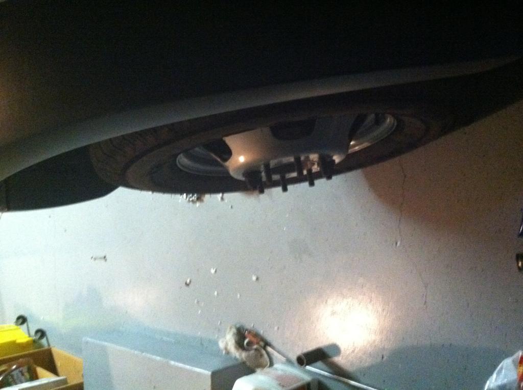

Back space wheel with adapter?
I know there are alot of threads on back spacing and offset. I wish there was a longer factory adapter. I need about 2 more inches to have the wheel in the right position.

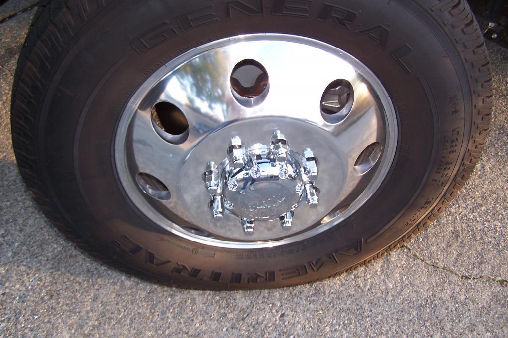

Thanks to Fred at wheeladapters.com I have a solution. I installed a custom built steel wheel spacer. This spacer is exactly two inches and places the tire perfectly in the wheel opening. New alcoa wheels tomorrow. Man this project was expensive.. note to file.. if you want the look of a 4500.. buy a 4500 lol

It's there a concern that the added wheel spacer will add unneeded stress on the wheel bearing? I would think this would make the fall apart even faster.
BTW- I think it will look great finished!!!
Old Dec 2, 2011 | 08:52 PM
Airslide's Avatar
Joined: Aug 2011
Posts: 67
From: Novato, Calif.
I dont really know how that bearing will deal with the offset. Its the same wheel so everything is moved out exactly two inches. Time will tell.
I can report that the truck tracks much better now with the offset. I was all prepared to be dissappointed in a strange steering sensation and it turns out that its much more stable. I will get some pictures tomorrow of the final product.

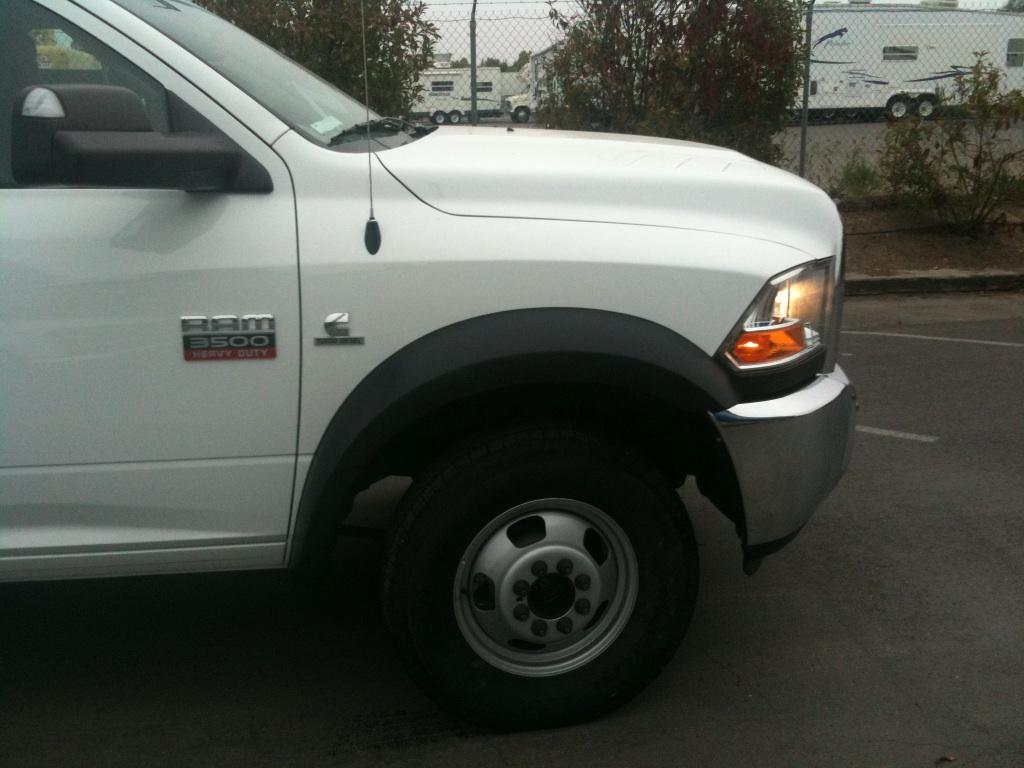

The final product.. a 3500 that thinks its a 4500
