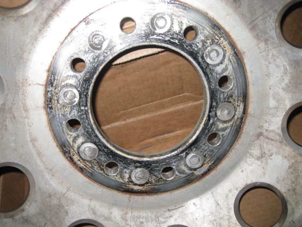

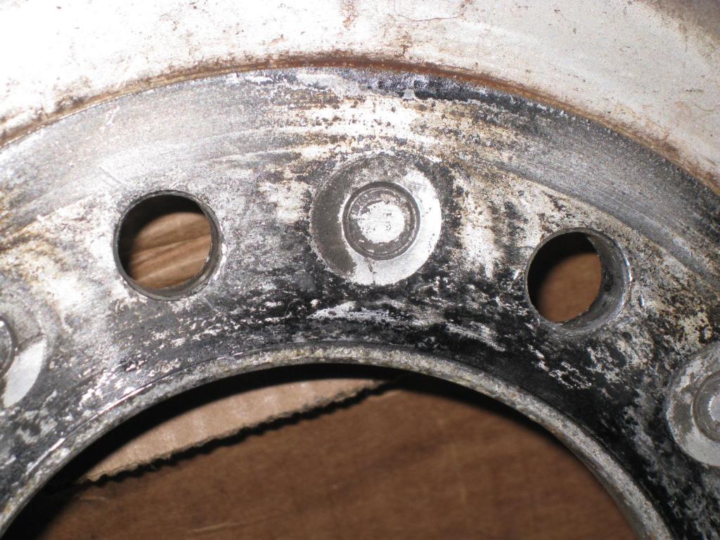

Thumbs up Spacer Conclusion
I put the new set of rims on and pulled the Alcoas off. The spacers have long been taken off. I looked at the back of the rims and there was an actual slight indent of the studs which means they were longer then the spacers. "See pictures"
Here is a write up from Blake that everyone should know before installing spacers:
https://www.dieseltruckresource.com/...58#post3139558
Since my studs were a hair longer then the spacer, the rims could not sit flush, thus causing my issue. I have ran many sets of spacers and did not know about shaving the studs, nor did I think that that hair sticking out would have caused my studs to shear.
I am not trying to blame anyone (even myself), I just hope people can read and learn from this, and not have to go through what I did or worse.
My new rims have enough offset, so I won't be re-running spacers up front, but I still have them on my duals as well as my 02 Dually.
