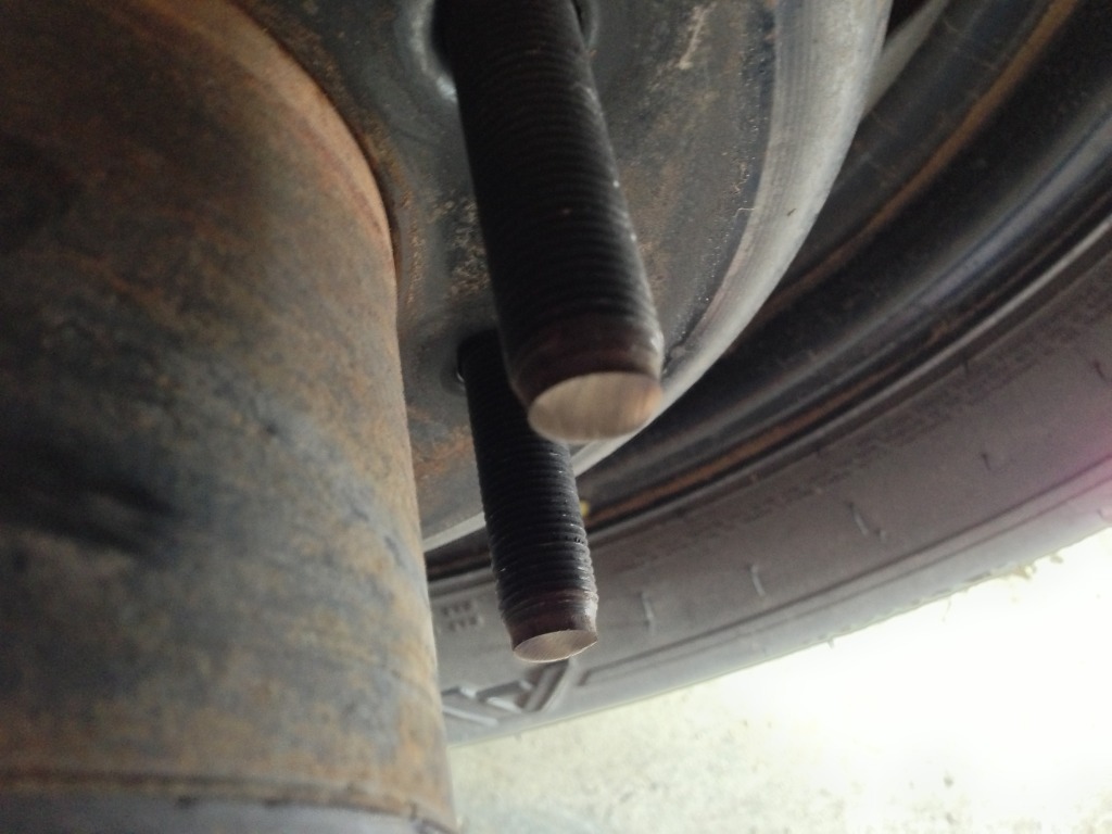

Here you can see what the factory lugs look like. Notice the small tapered part that has no thread.

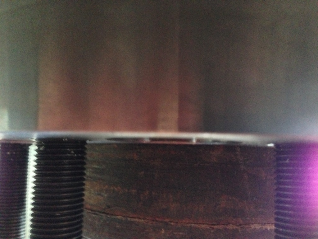

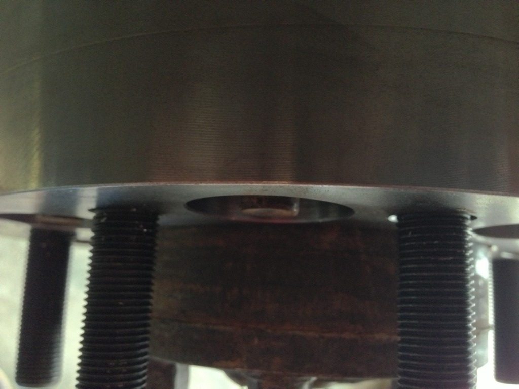

Here are the spacers sitting on the factory lugs, no modifications. Notice that the factory lugs are protruding just ever so slightly past the spacer. Bad JuJu.....
This will cause issues. The lugs must be tweaked to provide the proper clearance. Doing so took me all of about 15 minutes. I used a 4" DeWalt grinder with a sanding pad.

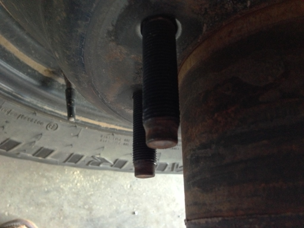

The lugs were sanded down approximately 1/8 of an inch. Just to where the taper on the lug starts to angle outward. No threads were harmed in the sanding of the lugs.
Now everybody is happy!
