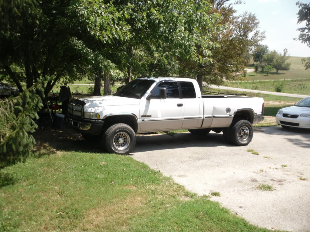

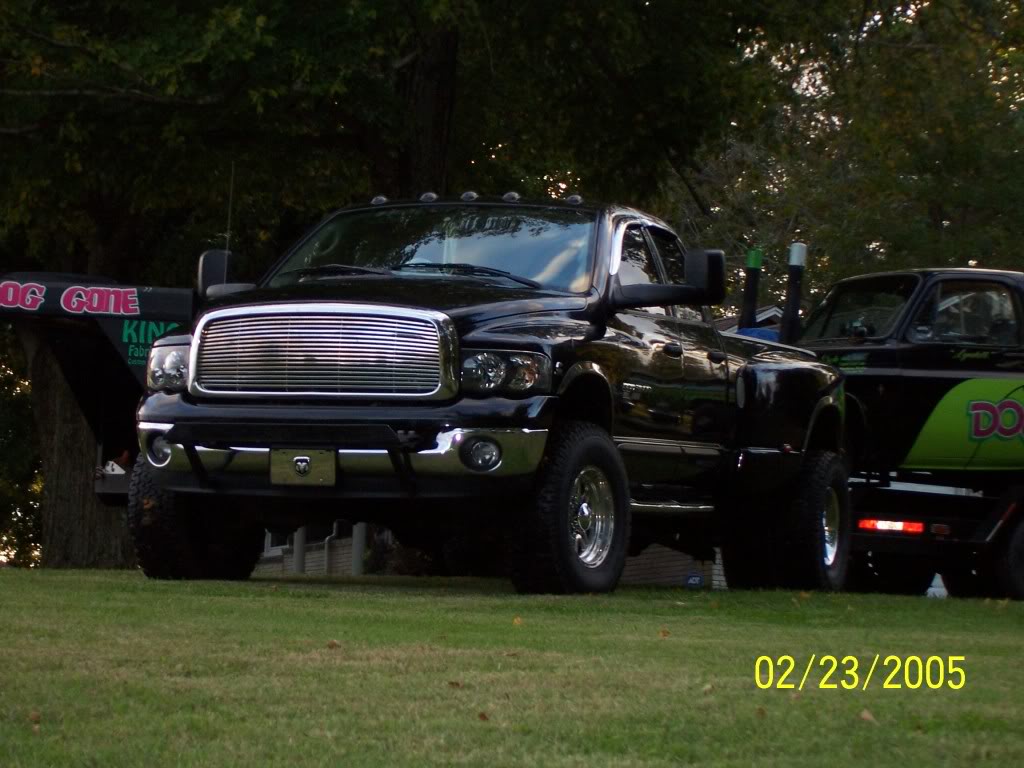

personal preference there now. it works. but I don't like the look.
