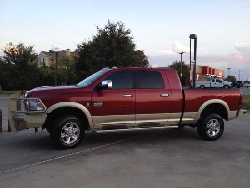

I just did a delete with the mini maxx race tuner on my truck. I need to know know what to upgrade so I don't break my transmission and my head gaskets. What all upgrades should I do? Also with it being stock at what parameter should I set my boost on so that way I don't have to replace factory studs until I can buy some better ones? I also have a S&B cold air intake as well...

Nice truck too!
