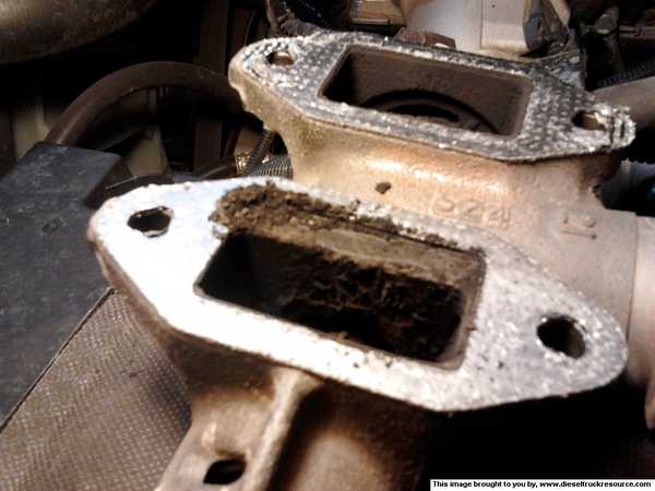

But first I decided to take a look and see how dirty things were, I didn't want to suck a big cloud of soot into the intake when the EGR opened up for the first time in weeks. What a dirty mess! Why do they even bother putting air cleaners on these trucks when they are constantly inhaling this stuff???
(pictures don't do it justice)
