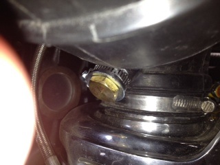

Did a CCV filter bypass "Home made" system today.
Basically I went to the Hardware store and got a 3/4" Pipe Plug and washer. Placed it into the opening in the Intake and clamped it down. Now, no more oil in the Turbine Inlet.

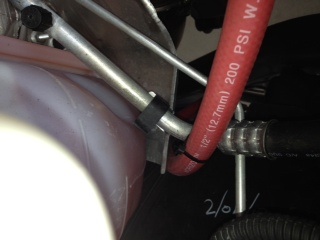

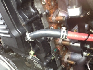

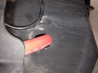

As far as the Outlet on the CCV filter side, I simply ran 3/4" hose down to the frame and into a hole that was already pre-existing. Overall, $3.48 spent, and no more oil into my brand new turbo. I will be posting pics tomorrow.
As far as removing the stock hardware and hoses, VERY VERY simple!!! Even if you still have the EGR system in place, this mod is code free.
ANOTHER OBSERVATION, my hoses were completely filled with oil, which means your VGT or aftermarket turbo is being FILLED with OIL!! I cannot believe how much oil was in there.

Here are the pics from my install.
Enjoy, PM with questions.

No filter on the end of the hose. (as long as you do not care about oil drip, no filter required)
I never heard a squeak when shutting down. But, there was an ubsurd amount of oil in the stock tube.
SOHap... Yes, the oil is now "Lubricating my Chassis" HaHa
