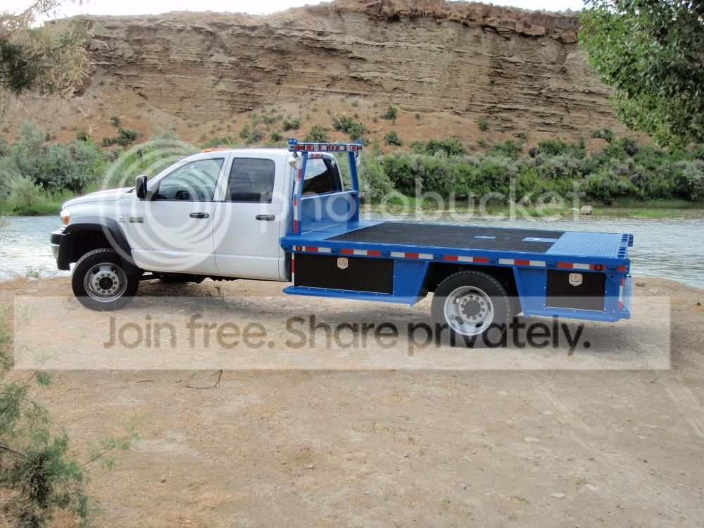

Since your going to be over the road I would get the 188.5 WB and have a DOT compliant sleeper put behind the cab. This would still give you room to hook up to your trailer

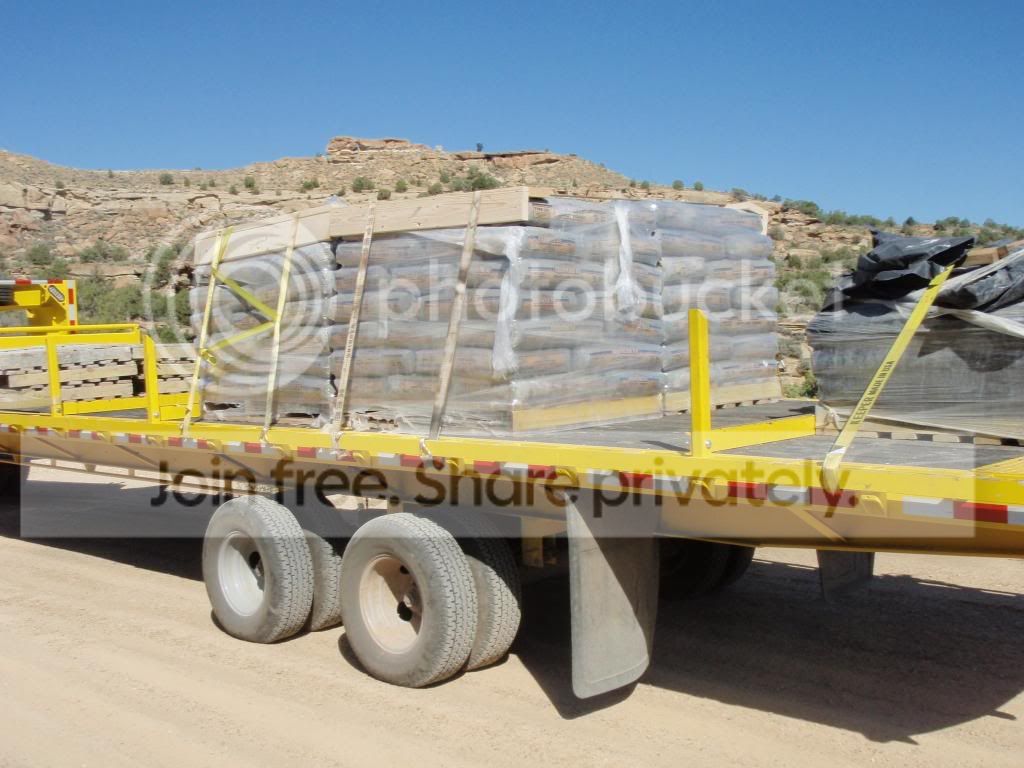

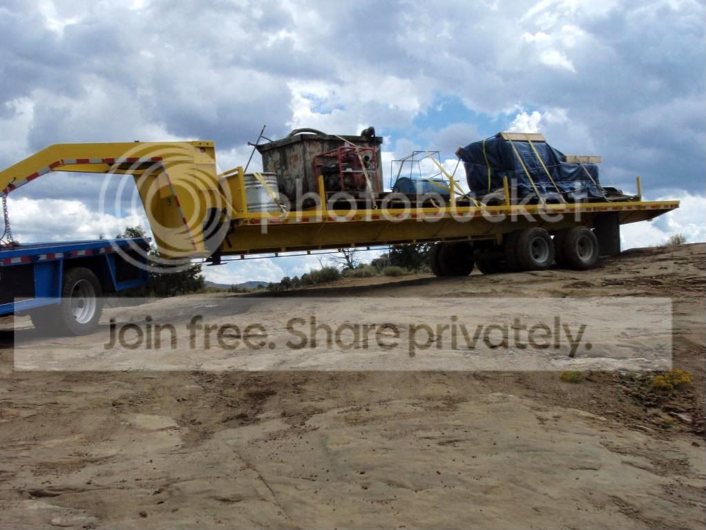

Here's my Beast:
And it's Burdens:

Thanks,
Technically I am a consultant in the gas patch .. Services used to be hard to get so I had to expand my line of services.. Now the "Gas Patch" is dead..
You could go with a quad or a standard cab and put the DOT sleeper on the flatbed.. If your going to be calling the road "Home" a quad with a sleeper will give you more room for your "stuff"
