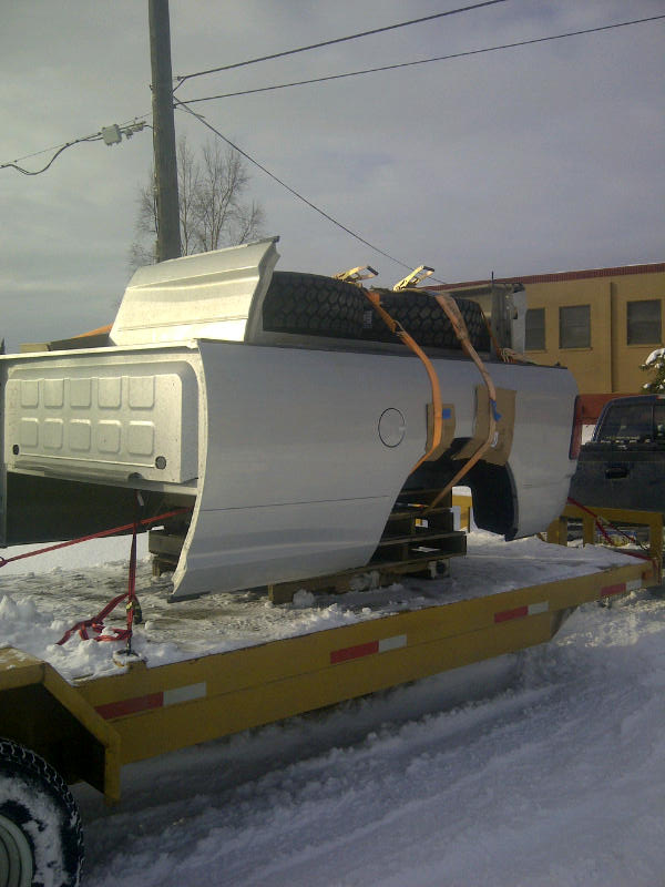

Getting rid of the dually and building the truck I wish someone would build. Just ordered a 13 5500 crew Laramie with 60" cab to axle with 4.88's and 4x4 with auto. Two pickup beds are enroute, rickson drw to super single wheels are 6 weeks out, toyo M608z tires are going on in summer which are ordered, and swamped irok 36x13.5x19.5 tires will be studded and siped for the winter, blue lake off road winch bumper for front and rear tow bumper, 40 gallon mid tank, and gooseneck hitch. Prob be ready around may time frame. 30k tow package in a single rear wheel. Thought about doing a 3500, but 5500 was cheaper by 5k and by time all said and done, will be much beefier and turn much better with wider front axle. Thought long and hard about 4.44s, but I tow a lot more and will be better at 60 mph speeds. I will post pics and updates as they come.
