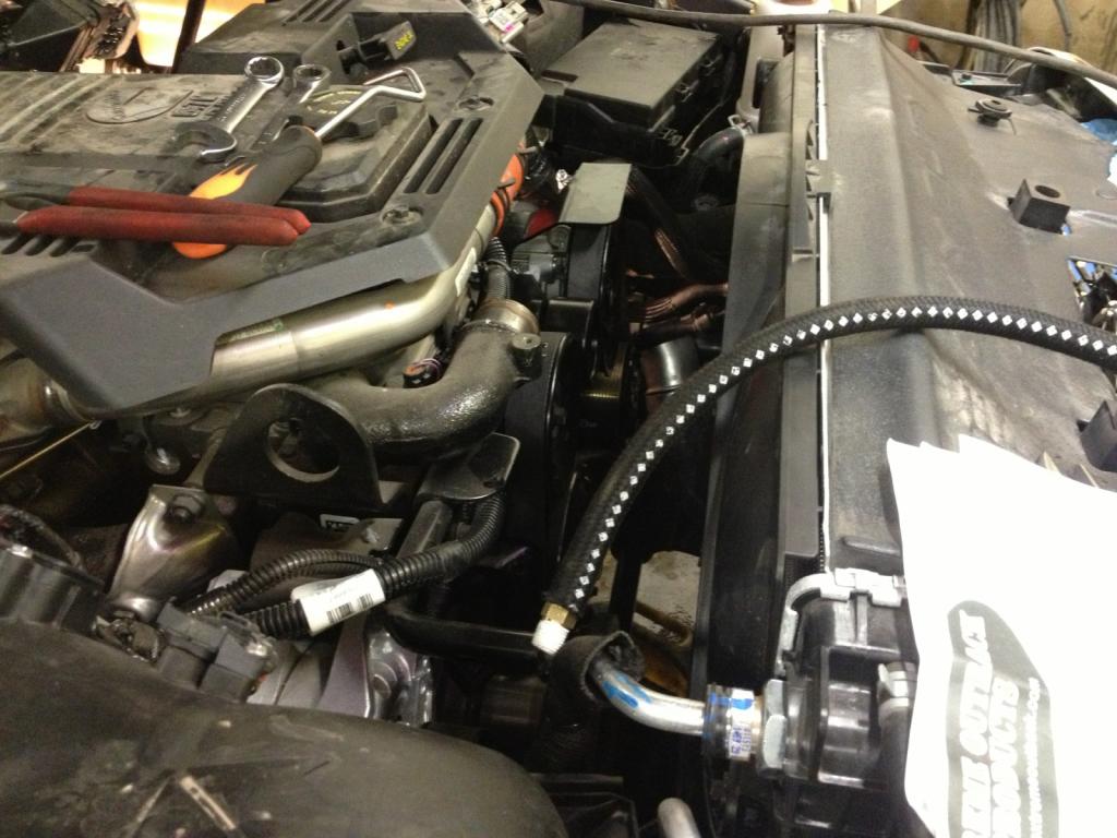

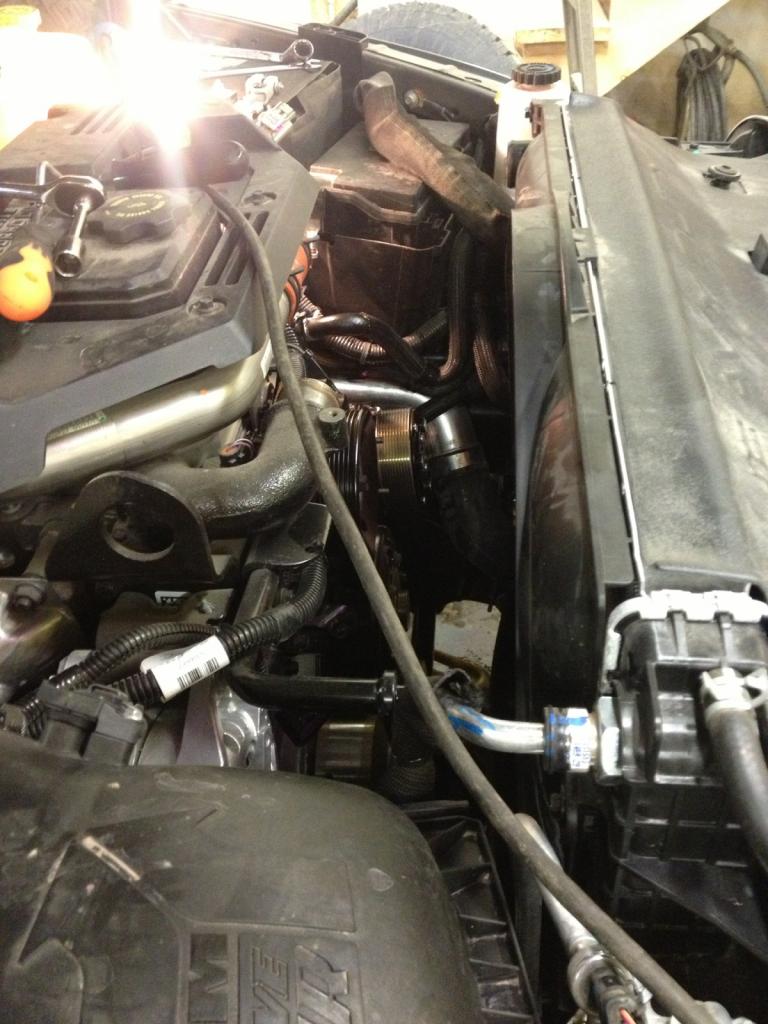

Here are some pics of the compressor going in. I apologize for not getting step by step, once plugging away i forget to take photos.
Here are some more. Hope they are in order.
There are some differences on the 2013's compared to the other 4th gens. The power steering pump on the 13 does not have a resevoir built on to the pump. The 12's and older had them attached. THe instructions show this. However, on my truck there is a seperate resevoir just to the outside or right of the radiator (looking from the front back towards the motor). I thought this might cause some problems with the fluid not flowing into the pump as they are real close to level, but the power steering pump sucked in the new atf+4 and it works fine. There are a few more power steering hoses to deal with that the normal system didnt have, but I routed everything around and have clearance. The power steering line coming from the gear box to the resevoir had to be bent towards the tire, but it worked out.
The auto trans was another non issue that the 12's and older have. The tranny lines come out on the passenger side now. According to the instructions, you need to cut and put on new hoses but that is not true on the 13. That took alot of time to figure out on the kit without anyone doing this kit before. Even the manufacturer has not done a 13. I was the R&D guy. So that right there saves quite a bit of time.
and here is the power stering pump with the hose I had to make to flow from the bottom of the resevoir, and the finished product. The red wire was ran to the pressure switch and that was ran to my #1 aux upfitter switch.
