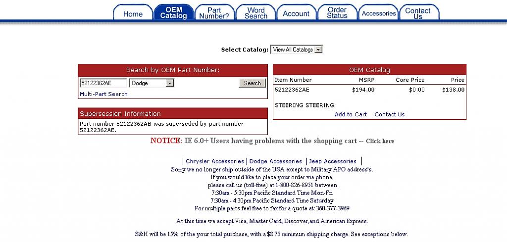

OK.............After reading through all 11 pages of this thread. I have a feeling that everyone agrees that this upgrade is fantastic.
However, I have found that there is no definitive agreement on part numbers of the kit.
So, I would like to know what is the definitive part # / kit # for everything - bars, pitman arm, stabilizer shock, hardware?
Old Dec 14, 2008 | 05:42 PM
  #159
hoot's Avatar
Joined: Feb 2002
Posts: 745
From: SE PA
Here are the part numbers, there is no total kit
52122362AB---Updated Steering assy (Rev B) Most likely none available
52122362AE---Updated Steering assy (Rev E)
68039930AA---Updated Pitman Arm
52122370AB---Steering Damper
6502473---Bolt (1), to attach steering damper
6505623AA---Nuts (3), to attach new linkage
6502835---Nuts (2), to attach steering damper
Just buy one of the Updated Steering assy part numbers. Whichever one you find is good.
Then buy the rest.
Just remember the price shown below is wrong. They will contact you and change it to $222

Originally Posted by wiskeyVI
I can't get any of these numbers to work on the Dodgeparts. site.
Any suggestions?
They won't show up through the search engine on dodgeparts.com's main page. You have to click the "OEM catalog" button at the top of the main page, then imput your make and part number through that search engine. It will then produce results for the parts you are looking for.
I had to punch in"2008" or nothing would come up.
