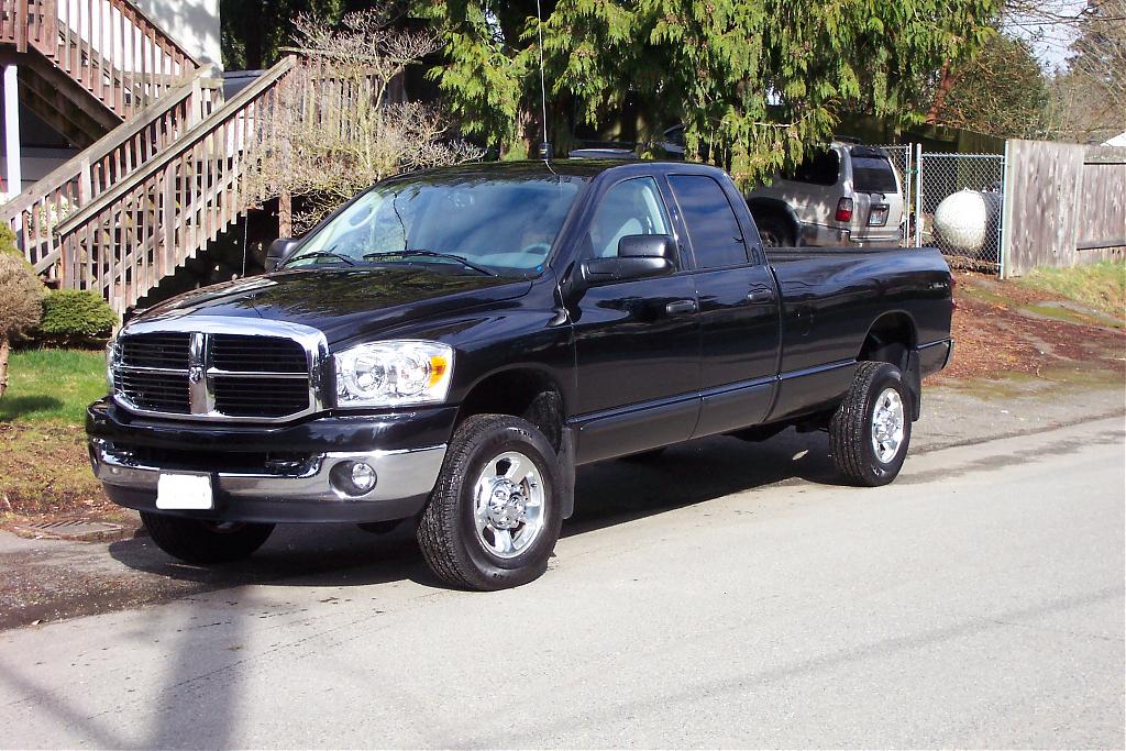

That video is hilarious. That is how I did mine with the the exception of the fishing line. I used 40lbs braid.
