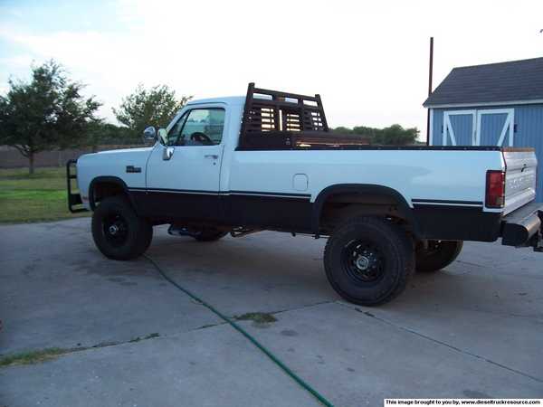

My 93 is sprayed like that.
My advice to you, make sure you take it to an actual, well credited, LineX dealer....basicly, anyone who knows what he/she is doing. Most places dont even sand the surface down before spraying and that causes it the peel later on in its life. Also, make sure its sprayed on thick. If its to thin in some spots, especially edges, itll start to peel.
Also, some places offer a "color" spray. Make sure that the spray itself is actually the color you want. Ive seen one rip off color spray job....the bed was sprayed in black, but the shop spray painted the new black bed red to match the truck. Obviously, it began to show in a few days when the spray paint would rub off.
thats my 2¢
