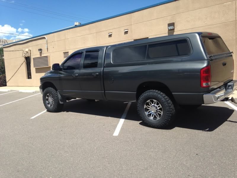

I CAN NOT speak any higher of Goodyear Wrangler Duratrac's!!!
I'm serious! I drive mostly highway, but Colorado has some nice snow and mud moments. I do drive in the hills, and through construction sites frequently.
These tires are the best I've ever had!
They have a nice aggressive tread, but they aren't too loud on the highway. All three sets I've had on the truck have lasted about 40k each.
I had hummer wheels on the truck, till last Friday, and they have the proper back spacing needed to run 315's.
I believe they push the wheels out .5", and they are 8.5" wide vs 8" stock. They are designed for the 315's so the tread wears even all the way across.
I had oversized tires on my dually (285's) and the centre would wear really fast and the inside and outside edges would wear very slow.
This is because the tire bubbled in the center making the contact patch in the center of the tire vs across the whole tread.
I would probably advise against 315's without a different rim. I do get a tiny bit of rub at full lock on the control arms but that only lasts till these wear down a bit.
I'm betting on a stock wheel, you'll rub like crazy. And with working on a ranch, you don't want that.

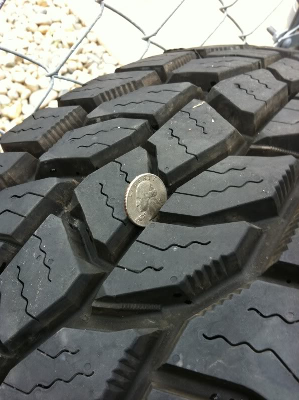

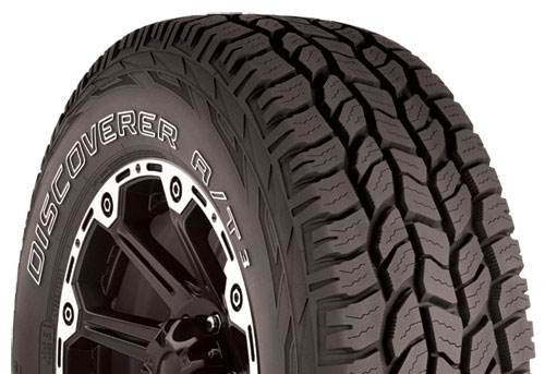

I just put the Cooper Discoverer AT/3's on mine and couldn't be happier. Definitely worth taking a look at. Plus Cooper now has a $80 rebate available! And they are made in the USA!!
