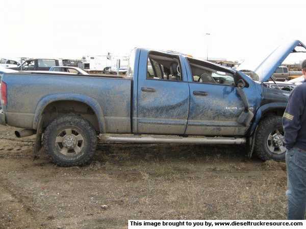

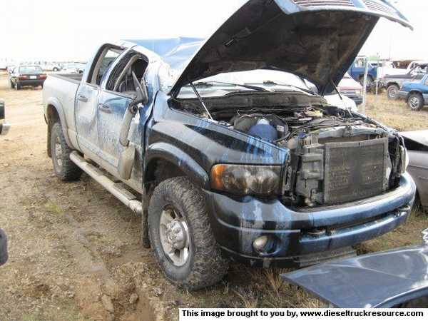

Has anyone here swapped out bodies on a 3rd gen? I gently (at less then 10mph) rolled my 04.5 last fall. I bought the truck back from the insurance company, and just recently bought a 05 2wd hemi off ebay. I plan on taking the complete body off the 05 and putting it on the frame of my 04.5. I know this sounds like a lot of work, but I’m going ahead with it anyways. I bought the 05 for less then the cost of parts on my insurance estimate, and by using the body of a complete undamaged truck I won’t have to pay anyone to do any bodywork.

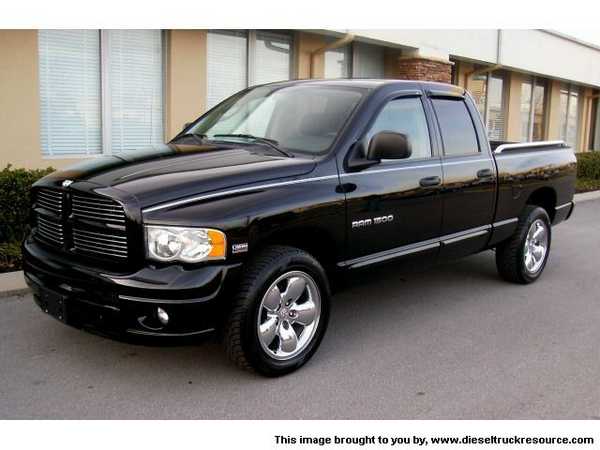

My 04.5 was a SLT, and the 05 is a Laramie. It has a few extra options that my 04.5, didn’t have. Such as heated seats, sunroof, and dual zone climate control. What kind of wiring nightmare am I in for? I know I will have to swap out the instrument cluster, and most of the wiring under the hood, but I am hoping the that my 04.5 computer will work on the 05 Laramie cab without many having to swap out much of the wiring within the cab. Does anyone have any insight into this?

You're probably wondering how I rolled my truck. I was driving on a gravel road when I slowed down and pulled over to the side of the road to turn around. There was a big culvert that was only about a foot from the edge of the road. The culvert collapsed and my front tire slipped off the road into the huge hole around the culvert. This caused my truck to roll onto its roof. Nobody was injured, but I'm surprised at how badly the roof caved in. It was dark when this happened, but as you can see from the pic the hole was concealed with grass.
It was a freak accident that has caused me a lot of grief. I have filed a claim with the municipality and hope to recoup some of my expenses, as that culvert is obviously not up to code. I think things will work out in the end, but it will just take a lot of time and work.
