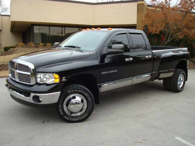

We are going to look at a 2004 3500 Saturday and more than likely will buy it if everything checks out and it looks as good in person as the pictures. It is a quad cab, DRW, 4x4, Laramie, and supposedly already has the B&W turnover gooseneck hitch in it. I hope that it really is the B&W so all I have to do is buy the companion hitch to pull my 5er.
I am keeping my 97 2500 and letting my son drive it so needless to say he is thrilled. He is going to need a real good job when he finishes school as he is already talking about stacks and other mods.
What are the main differences I am going to see in the 04? How can I tell if it has the HO engine? Is there a way to tell from the vin? The build date is 09/03. What kind of mileage can I expect? Will this truck have high idle?
I am just a little excited and full of questions. If there is anything else I need to know, good or bad, for this model year, please let me know.
