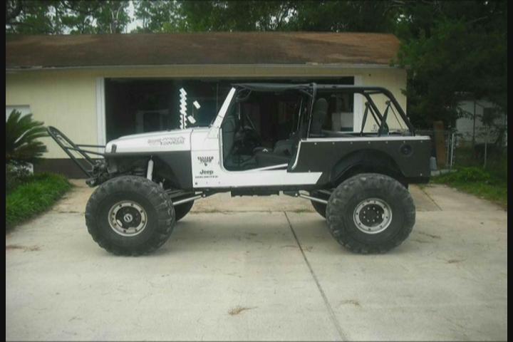

The Jeep is my baby, although I am getting ready to start building a full tube chassis "rock buggy" in a few months.
After the first build
What it looks like now during the wheelbase stretch
