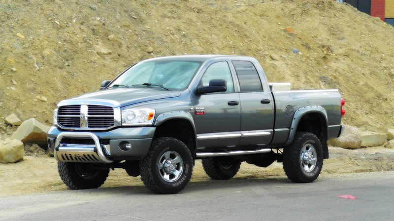

For my own reference, i found this picture on another forum. says its 4" lift and 35x12.50.

i can't imagine going any taller on my truck just for getting in and out alone. much less the other problems you will encounter.

driveline angles, steering link angles, control arms to short, track bar and drag link need to stay in line, which gets hard to do once you start adding drop backets. 3" seems to be the line, mine is short of that. hell you can fit 35" tires at stock, the only reason i added any lift was i needed an upgraded susp. for off-road overland use. the shortest system made is about 2.75"
not trying to insult you, to each their own. just didn't want you to go jumping into it with out looking at what it takes to go higher.
