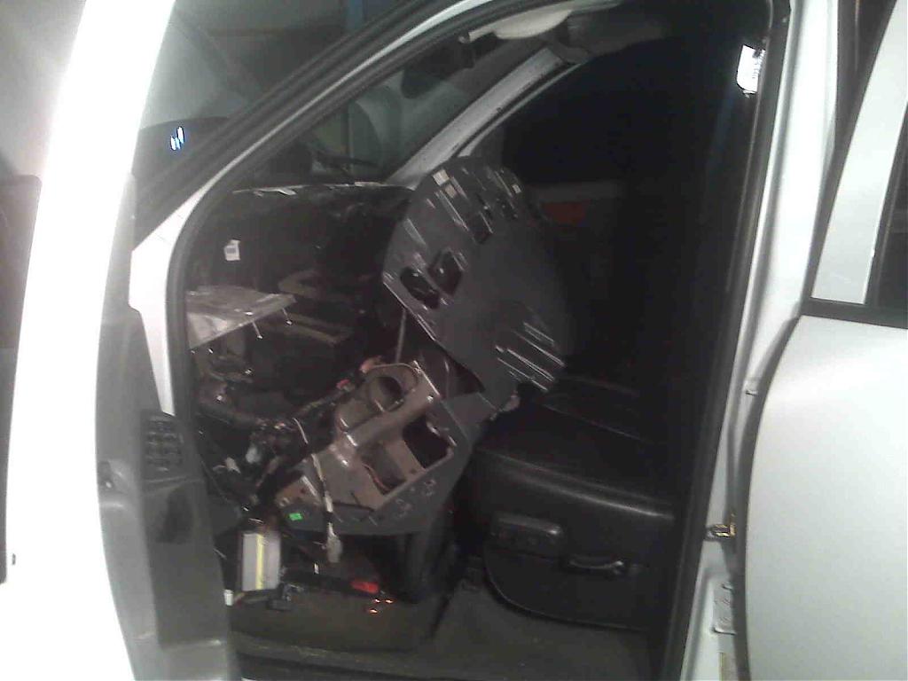

my mechanic got the dash out,
and I stopped by for the door swapping.

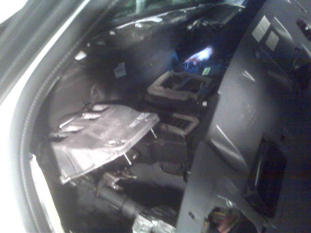

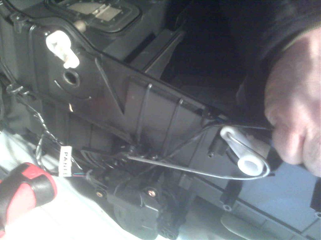

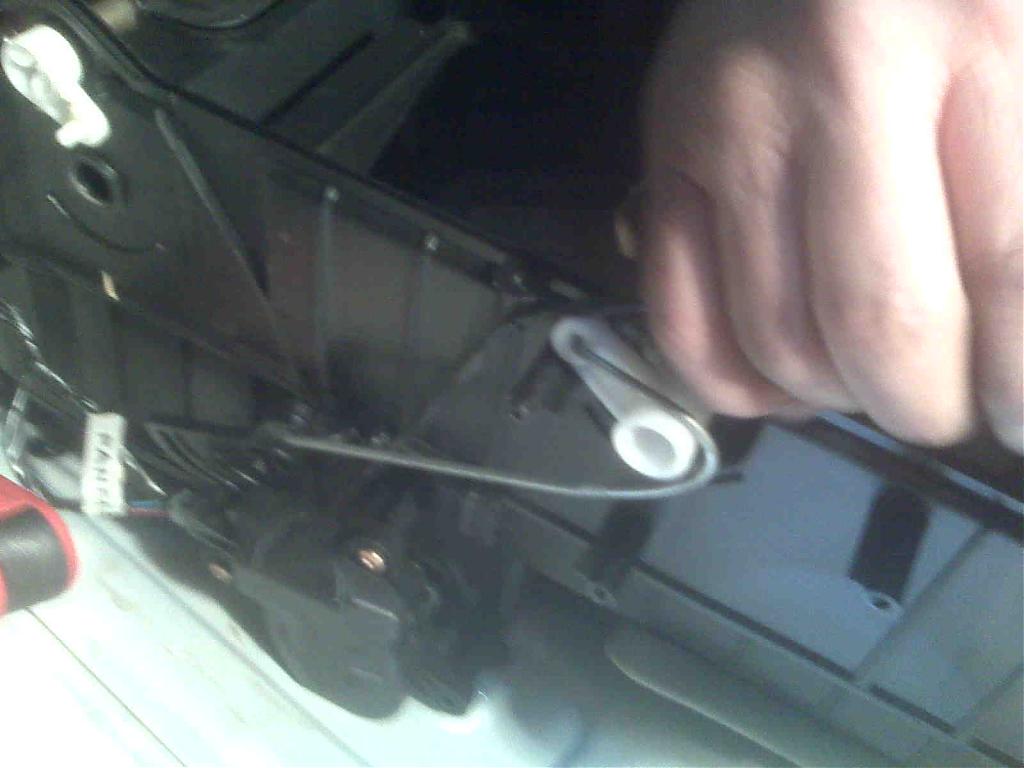

if you see the reach rod, and the black plastic peice hanging on the left end, it goes into that empty hole by the white arm, and that activates the flappers in the top right of the pic.
those flappers lead out the bottom, downward to the Mega Cab vents.
that metal arm was supposed be straight.
the Heater Treater parts do not allow for the operating arm to be re-attached under the actuator, from what I looked at.
we straightened the metal arm out, and played it with, but ended up leaving it off (since the operating arm would not attach under the actuator) and opening the mega flappers WOT. the assembly only opened them ~75%
