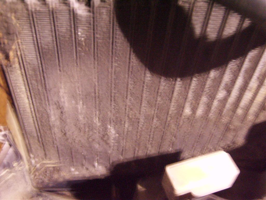

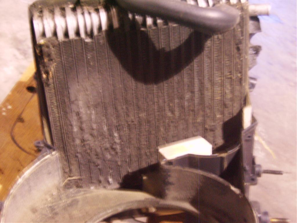

Well, here is one I am working on right now.
This thing stunk like you would not beleive. I hope you don't have to go through all this.

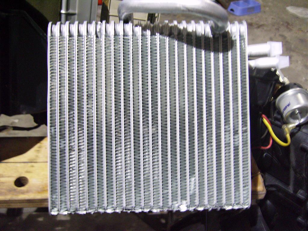

This is what it should look like
what is that called?
and how did you get it out??
mine could be like that.. i have 170K.. and the truck was "well used"
That my friend is the evaporator from the HVAC box under and behind the dash.
You have to remove the entire dash to get it out, and several things under the hood too. I swear I will never do another one again, it is a nitemare.
