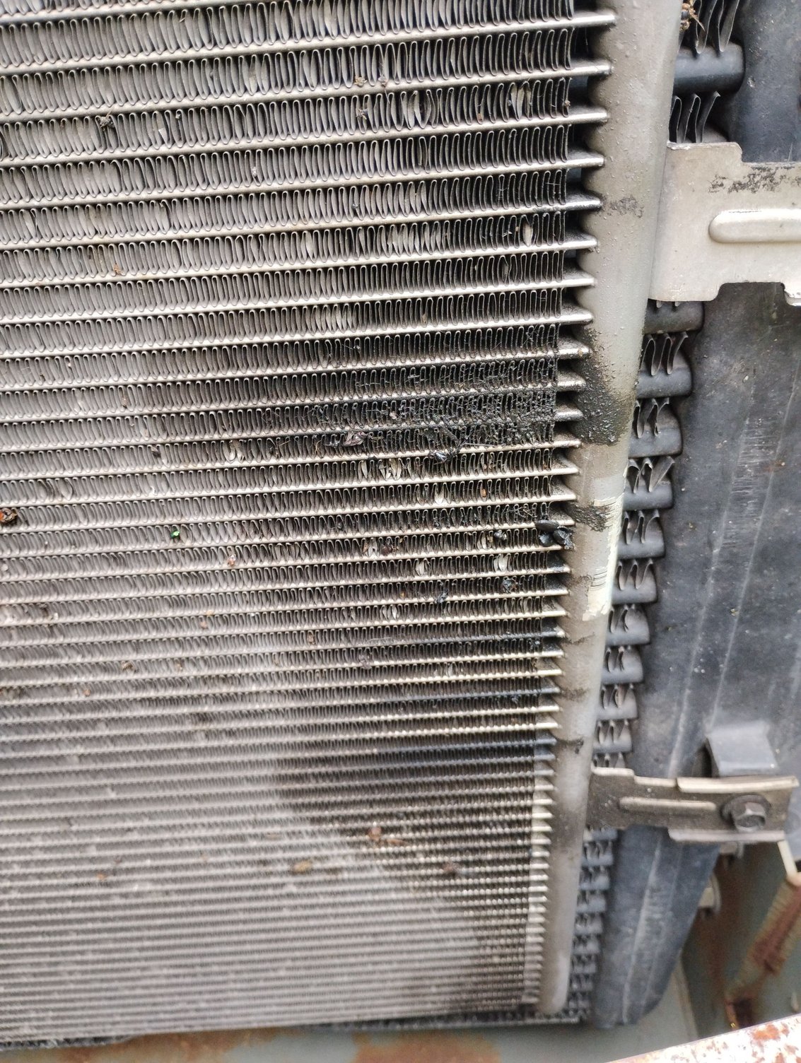

Hey fellas earlier this spring when it started getting hot I noticed my A/C wasn’t getting cold. I assumed I had a slow leak since I had my A/C charged last year. I had the service station charge it and it was cold. A couple weeks ago I noticed my A/C stopped getting cold and then the blower would intermittently run slow or not run at all. Now the fan doesn’t blow at all. I got up this morning to trouble shoot and noticed my condenser had what appears to be a leak. Would no coolant cause the fan to not come on at all? or do I have permanent damage? If I replace the condenser and recharge the system will it start running again or maybe not? Thanks for any help in advance.

The fan should run no matter what. If the freon gets low the ac compressor will not come on but the blower fan should still work!
