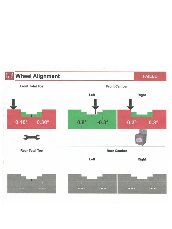

I also have a 2006 Dodge Ram 2500 5.9L (92k miles). When I got my last tire balance & rotation, the shop checked my alignment. The attachment shows the results printout. They told me that to correct the alignment, I need to replace the OEM upper ball joints with adjustable ones. I jacked it up and when pulling/pushing the tires at 6 & 12, I can hear a little play at the upper passenger BJ. I figured that I might as well change all 4 BJs.
I'm trying to figure out if it's best to go with regular, non-adjustable BJs or adjustable BJs. Will installing non-adjusting automatically put the camber back within tolerance? I'm also interested in hearing other owners and/or mechanics experiences with brands (Carli vs Dynatrac vs Moog).

From everything I've read here, carli is the way to go. Mine are still good. But when I'm ready to do it I'll use carli. I think danderson has done his with carli .I'm sure he'll chime in. Knows a lot about this stuff. Has good advice

I got in on a group buy+rebates from Dynatrac so I went with them for the freespins and bj's. Otherwise I might have used Carli's bj's.
Next front steering linkage will be the Synergy setup i posted depending on reviews.
I have ridden in a Carli 2.5 pintop with rear leafs and it's amazingly nice riding and handling. My trackbar is seven yrs old now and made my Thuren. His coils are great although a bit too soft for the leverage and weight of the camper. I have his 2.5 Kings. Quite a suspension mutt with Kore front coils. Mismatched but it actually works well.
