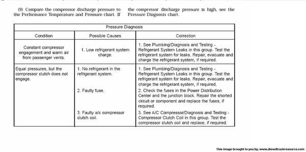

Dude, you need gauges! Don't ever attempt to add freon without monitoring the pressures. And the pressures varies with the ambient temperature.
Not using gauges is a good way of damaging the AC system.
Here's a copy of the pressure chart:

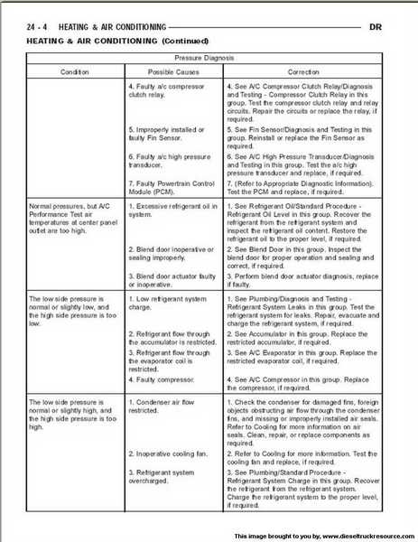

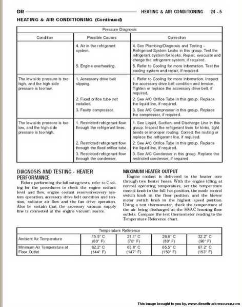

Sometimes it's hard to tell if someone is using gauges or not.
Yes, its the factory service manual. Geno's Garage has the manuals.
More pages from the manual.
