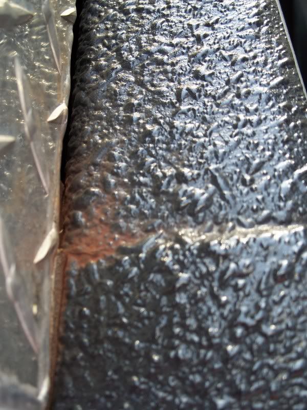

How about a picture?

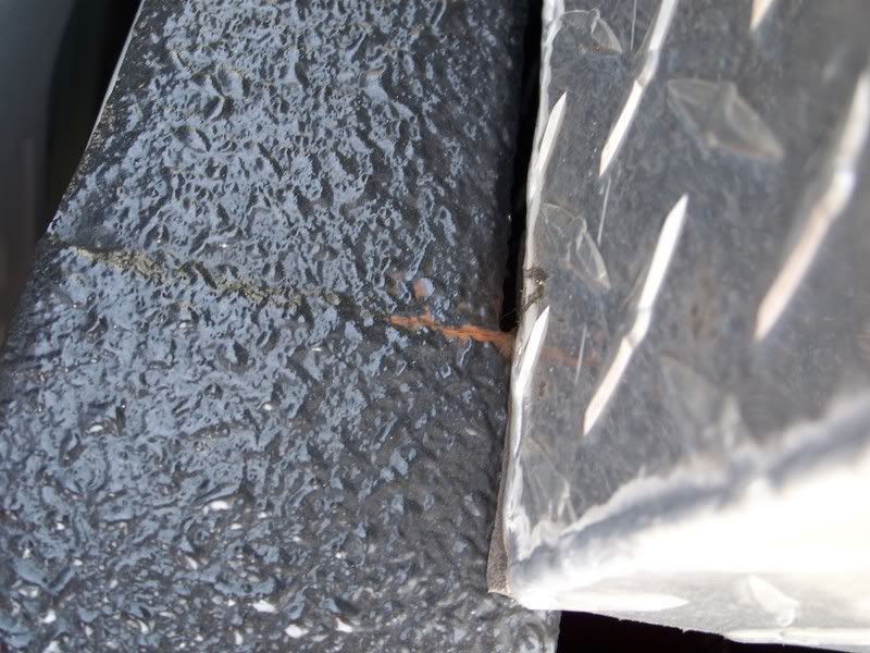

Heres a couple of pics for ya. Hard to tell whats going on in them with the spray on liner but it would appear that the area where the bed sides overlap the center on the front have either cracked or it just moves enough to allow water to enter and rust.
The first pic is drivers side, the second is pass side.
