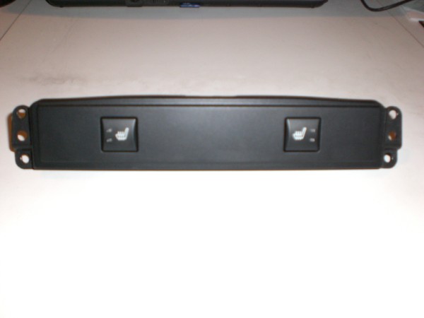

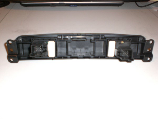

Switches
I have a set of Dodge Factory switches for an 06 with the panel they fit into. Trucks for sale so I wont need them. I have 115.00 in them and will sell them for 105.00 delivered to your door.
