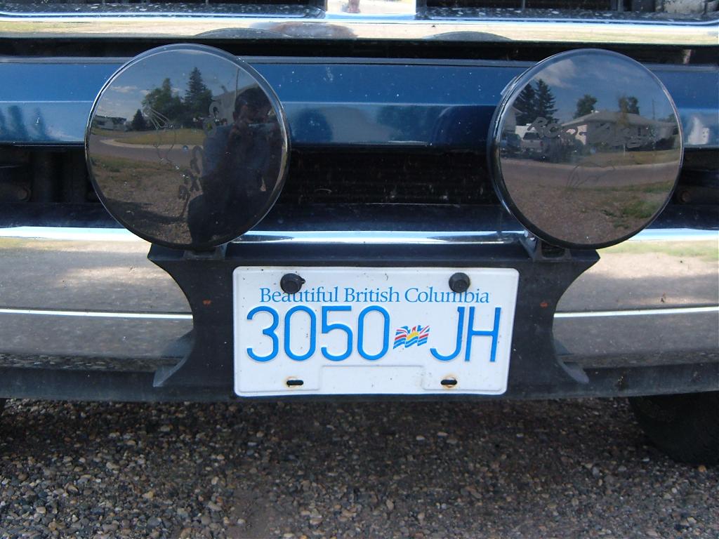

Hey guys, I just put on some new driving lights. They are a 6" Roo-Lite. I thought the headlights on my 06 were awesome compared to the lights on my old 2001. But after running these at night with the high beam on, and then turning them off. You start to lean forward to the windshield to see better. I'm going to try to post some pictures of the difference with them on and off. This will be the first time trying, so hopefully can get it to work.
The picture on the left is with high beams only, Right is with driving lights and high beams
Jon

Wow their great, they look good too in the 3rd pic. Did they come with everything including the harness around your license plate?

Thank you, The lights just came with an extra bulb. I had to buy the harness separate from NAPA for $42. The harness is made buy the same companys as lights so it was pretty simple. I just made the light and licence plate bar my self.

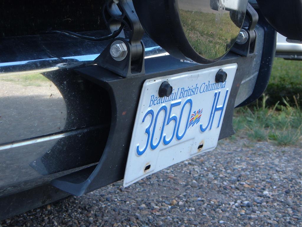

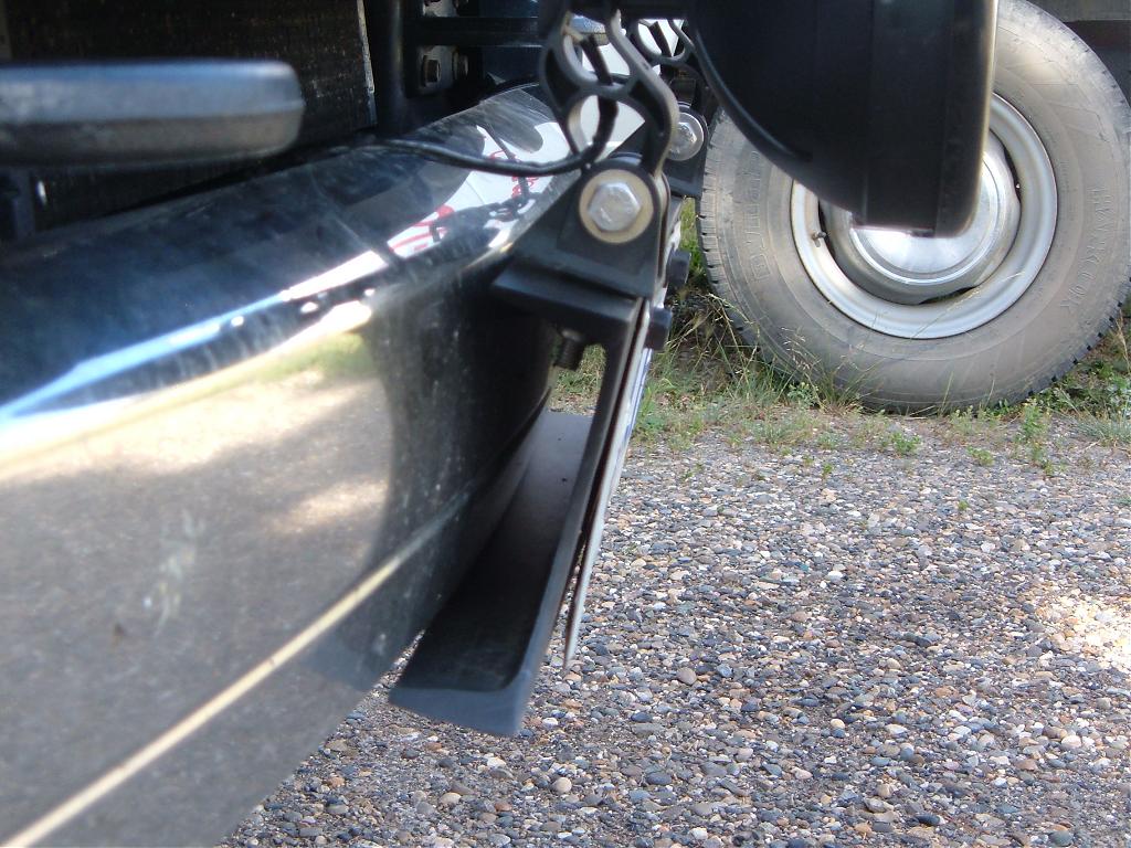

Wow! Thats great. Could you post a close up picture of the bracket? Thanks

The bracket is 6" "C" chanel that I drilled for the factory licence plate holes in the bumper, then used grinder to make the radius cuts. It's nice because the bolts for the lights are hidden between the bumper and fthe light bar, so hopefully can't be stolen (as easily). I will get some close up pictures tomorrow.

Cowboydave here are the close up pictures for you
So how is the 6" channel fastened to the bumper? It looks great!

I would assume the 2 bolts hold it on the bumper, Enafzige.

Yeah, just the two bolts through plate then the bumper. The Bolts are about 4.50" long in order to make it through the metal behind the plastic bumper. You sandwich the plastic just a bit, just to make it snug.
