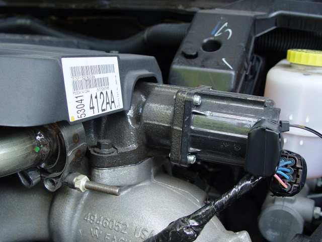

Thought I'd chime in here, being a new guy and all to this website. I've read all the posts, seen some pics of walking through this whole EGR thing, but, I'm not too sure on this whole DPF removal thing. I just picked up a new leftover '07 Megacab DRW (hopefully she'll treat me as good as my '06 2500 5.9 did), and I just unplugged the EGR, fired it up and no stumbling or anything, idled like she should, so I think I'm good to go. I'd like to remove the DPF, and seal the crossover. But, exactly where is this DPF flapper?? Here's a pic, is it the spring coil deal in the little case that the EGR plugs into, or somewhere within the pic?? Or am I still missing the boat here! LOL! You'd think after 25 or more pages I'd have a better understanding, but, reckon I'm just being ****, little nervous about tearing into a day old truck!! So far around town, with EGR plugged in, it looks like 12.5-13 on the overhead, with 400 miles. I post again with results of the unplugged mileage. You guys are great, can't believe all the info thats available to me on this site. Thanks.

The DPF is the huge canister right in front of your muffler in your exhaust. In front of the DPF is the NOx adsorber and in the downpipe is a Cat. The "flapper" that is mentioned in relation to the EGR is found inside the intake horn. If your truck isn't stumbling or anything with the EGR unplugged, there really isn't any reason to remove it. You can remove the crossover tube from the EGR cooler to the EGR itself if you wish. I think the Dorman freeze plug number that works to plug it is earlier in this thread.
