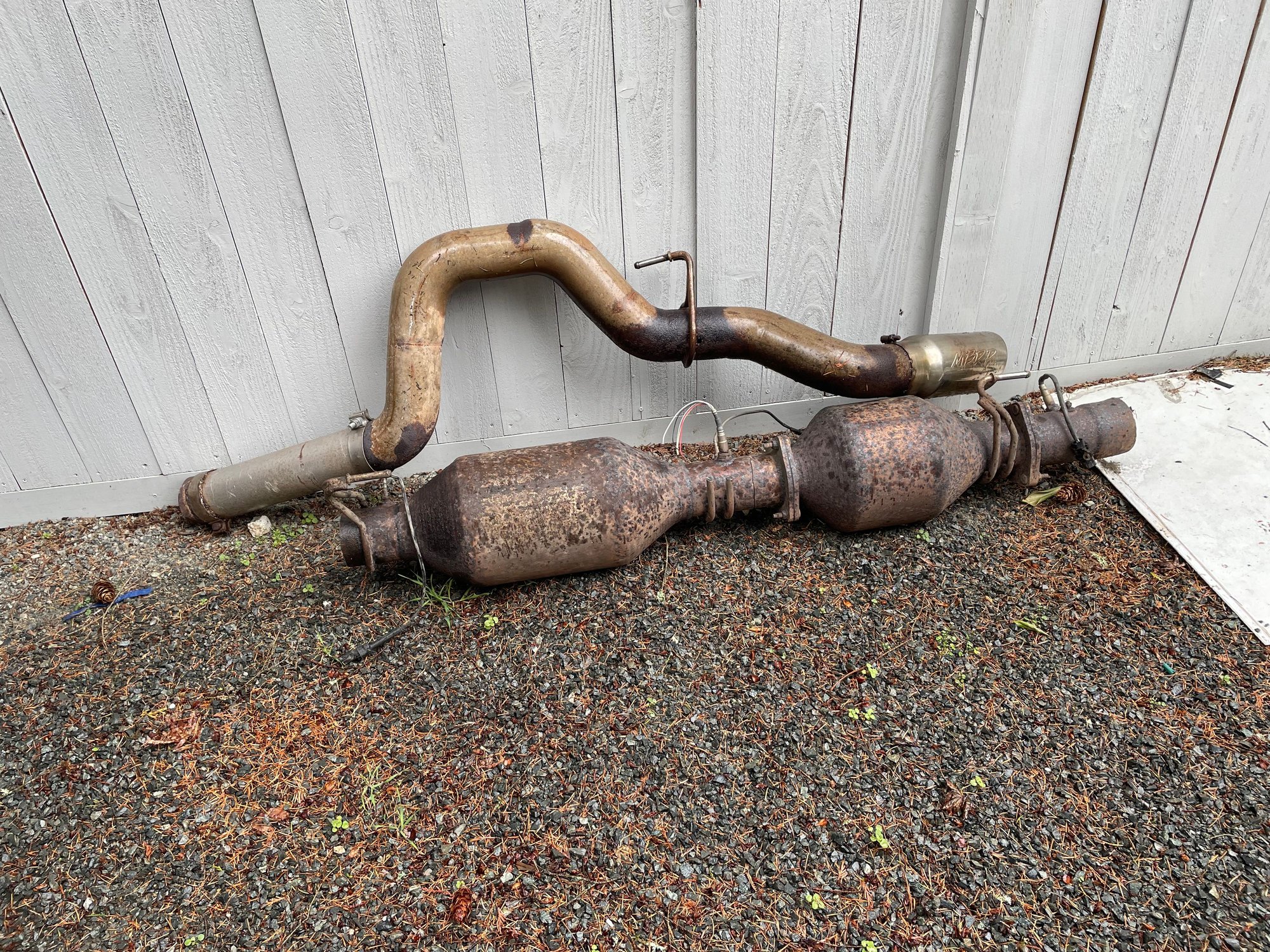

All deleted
but
leave the egr valve attached and baged and zip tied out of the way
and
leave the transmission air presure switch pluged in but disconnect the rubber hoses ?

You can remove the plunger from the egr actuator, reinstall the actuator and plug it in if you like.
Or if you're removing the egr valve then bag abd tie it up like you did.
DPF pressure sensor - you can just remove the rubber hoses and leave it plugged in.
This might give you an idea of the different ways to do it.
https://www.dieseltruckresource.com/...-right-273345/
