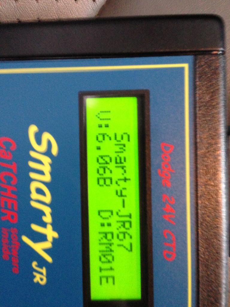

Do you know what tune you're running? If not just plug in the smarty and it will show the tune name. Post it here so we can see if its a delete tune or epa compliant one.
As said above, if you run a delete tune on a stock truck you will fill the dpf.
You will need an epa compliant tune for your truck.
Like I said above, more power = soot so if it filled while towing on sw-2, you may need to drop it to 1 or return it to stock to keep it from filling again.
Anyways, post your tune and we'll go from there.

So I have determined that , from the info above D:RMO1E .
I have to do the deletes first .
My serial number on the back of the jr is. SJ67P13015102,
So can I download the EPA tunes for my truck with this smarty jr?.

Yep, delete tuner and tune. No wonder the dpf filled up.
Yes, you can download the epa tune and run it until you delete. Your tuner will run either type of program.

I contacted a local repair shop that was smarty friendly and was told smarty has changed there tuners and the software was not downloadable ?
From the info above this is a ME tuner so I should be able to download the us EPA tunes? I am confused
I think the repair shop wanted to sell me a new tuner 1499.oo
Ok, time for a long response.
Your local shop is (kind of) correct and yes they almost sold you a new tuner! They may be smarty friendly, but not consumer friendly.
Yes mads has new US epa compliant ONLY tuners and tunes now and the ME delete tunes are no longer downloadable from their site. But they left out a bunch...
The tuner you have is delete capable. AND can load non-USA epa compatible tunes also.
ALL the tunes are still available and new ones are being written as needed. You just can't get the ME tunes from the mads website. You just need to know who to ask and pm them your email addy to have access to them. (hint-hint)
Mads has two different tunes available on their site, US epa compliant tunes for the new US-epa compliant tuners and NON-US epa compliant tunes for the older tuners such as yours.
The NON-US epa compliant tune is what you want to load on your tuner/truck until you want to do your deletes. Then you can later load the ME file and delete.
Your tuner is fully functional and the tunes are ALL downloadable for it.
