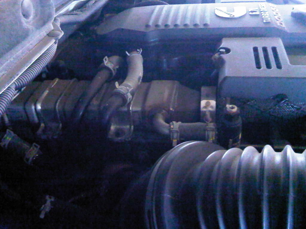

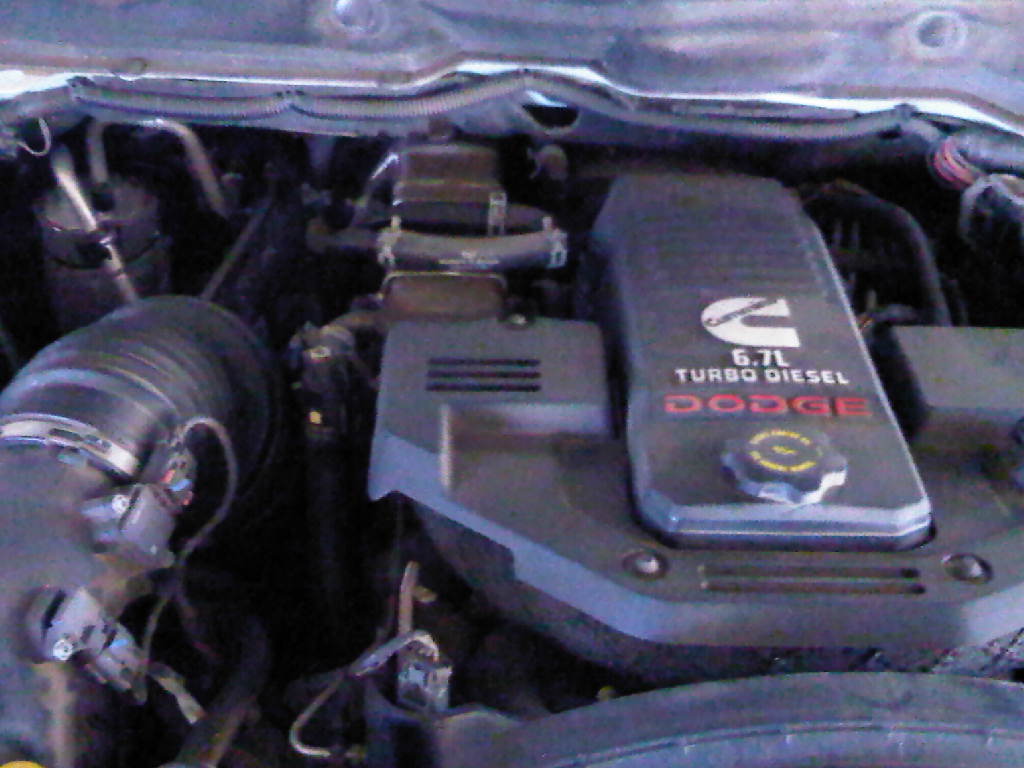

Here are a couple of pics of the engine. Also, I'm trying to figure out how to dl the ME software from the mad's site, but it is pretty confusing. I did find an old thread that gives some advice, the one with german in it, but still having trouble figuring it out on Windows 7...
Attached Thumbnails Q's about Smarty Jr and Cali-delete...-engine-1.jpg   Q's about Smarty Jr and Cali-delete...-engine2.jpg

Those pics show the EGR cooler, which sits on the exhaust. The EGR valve is on the other side on top of the intake.
Here is the page you want for the download:
http://www.madselectronics.com/CodeF...EGRDelete.html

I guess Im looking for something different than the pics that are on Mad's site and the ones Blake posted. I sure don't see anything that looks like a small motor sitting on top of my exhaust manifold. Am I just missing it? Can you edit one of my pics and point it out to me?

on the left pic, I have a thing that has a cable hooked to it, on top of like the exhaust manifold. Looks like your missing some parts on it
Thats exactly what I'm trying to figure out myself...Im still a beginner when it comes to these 6.7s, completely different than my old p-pumped 01...

correct me if 'm wrong, but I see no egr cooler, or even a place it would have went. not sure though, I have'nt looked at mine to see it really. Maybe its a mexico truck, not too sure if they have the emmision stuff
