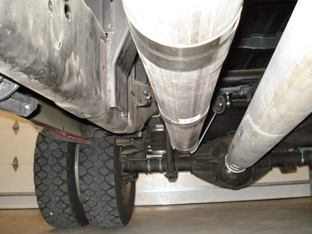

Thanks guys, I think I'll try the muffler route. The kit that Flo Pro sent me had muffler clamps in it so I subed in some Torctite clamps that make a sealed joint. I wonder if this makes it worse?

Old Nov 29, 2010 | 08:52 AM
surfram's Avatar
Posts: 1,125
From: Delaware
Originally Posted by Newblue
Got a Flo Pro 5" tbe and now have a bad drone at 2100 rpm or 75 mph on the highway. It is bad enough that it makes one of the back windows buzz. What can be done about this? 2007.5 dually, throttle valve,egr cooler deletes.
Thanks,
Mike
Are you running an exhaust tip? Getting the exhaust exit further away from the body of the truck can help alot.
Yeah, have a 5" to 5" silverline tip on it.
