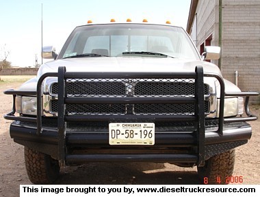

we built 4 of these and 3 rear

I did some research and found an old thread you posted pics in...looks great!! Where did you get the center uprights for the brush gaurd
